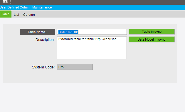

This is an old field from years ago. And I double checked and datamodel is synced.

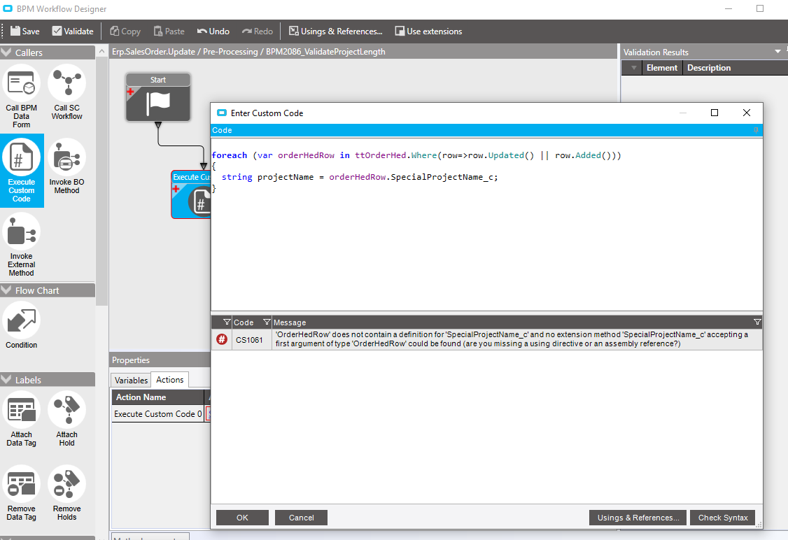

I have added two screenshots, on the first one as you can see it gives me an error not recognizing the custom field.
Try:
orderHedRow[“SpecialProjectName_c”]

Try using the following methods to get/set UDFs when dealing with temp tables:
string projectName = orderHedRow.UDField<String>("SpecialProjectName_c");
Change the type if SpecialProjectName_c is not a string.
To set it…
 orderHedRow.SetUDField<string>("SpecialProjectName_c", "New special project name");
Yes it worked! Thank you!!
