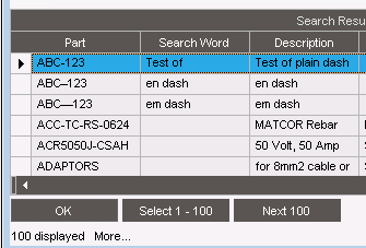

If someone creates a new PN, and pastes the new PartNum from their clipboard. But the “dash” in the data in the clipboard was really an “em dash” or “en dash”, it will be an entirely different P/N.
Each of the following P/N’s can coexist in the Part Master
ABC-123 “dash” (ASCII 45)
ABC–123 “en dash” (ASCII 150)
ABC—123 “em dash” (ASCII 151)
And if you don’t know the keyboard command for an "em dash or “en dash” you might be SOL, when trying to type that P/N in manually.
