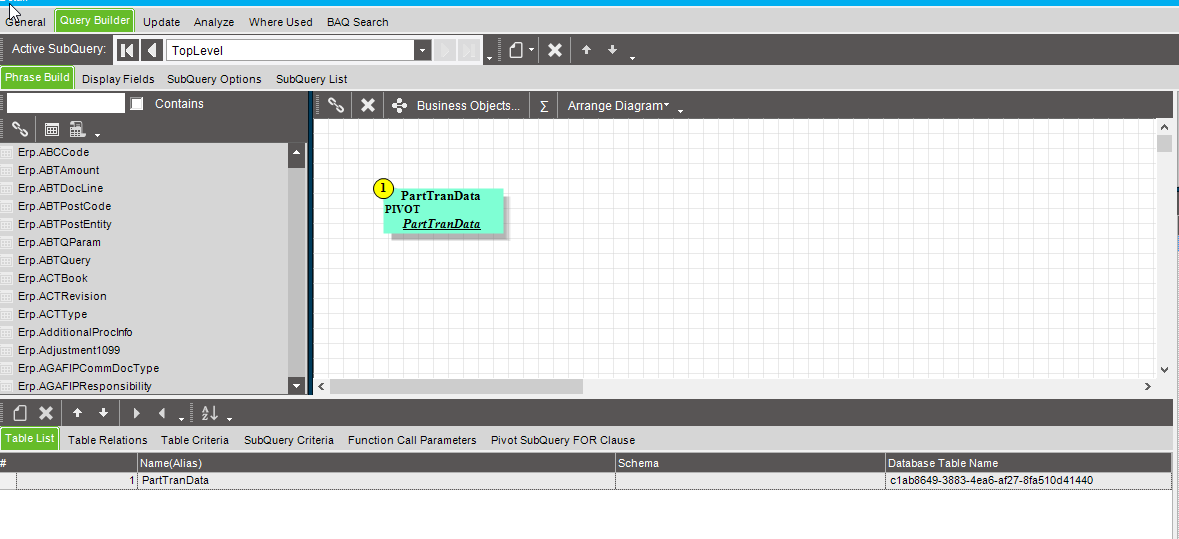

Can you post a screenshot of the BAQ design?
Does the Subquery table (PartTranData) link to any other table in the Top Level query? If not, why the subquery?
PartTranData is the subquery.
Right, but in the Top Level query, there does not appear to be any other table than from the subquery…

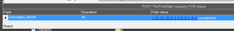

When I use this as a filter:
Both rows come back:
So if you filter by those two new part numbers in your BAQ report, do they both come back? Or still just one row?
With the filter in the BAQ set to two part numbers, if I run the report and select those two part numbers, I get the record for the first part number twice.
