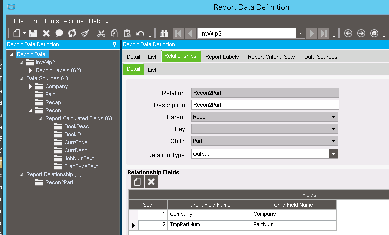

Add the Part Table to the RDD and then use the Lookup PartClass to get your info.
The “Trick” to adding the part table is to join on Recon.Company-Part.Company, and Recon.TmpPartNum - Part.PartNum
