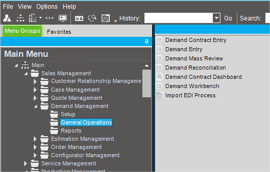

So, is Demand management part of the CRM or another module?
It is a separate module you would need to purchase from Epicor, when installed you usually will see it under Sales Management:
If you ask your CAM you can try getting a new license key for your training environment so you can enable it there and play with it.

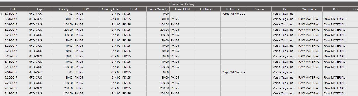

Awesome, thanks! For now, what do you guys make of this.
This part is our generic part for the b ig upfront orders.Trying to figure out the running total. Makes no sense to me, the number should go larger than -214.
Looks like Qty Bearing may not be enabled on your Part or the Part’s Site…
MFG-CUS is the transaction type displayed when you’re doing shipments straight from Job to customer – therefore I wouldn’t expect that to increase inventory anyway. If you look at the entire history for this part, do you have a QTY-ADJ or perhaps STK-CUS causing it to go negative 214? (the STK-CUS can be set at the Part Class level to allow negatives, warn on negative, or prevent negative qty).
Regards
Mark
Mark is right, my mistake, I was reading the MFG-CUS as MFG-STK… long day.
I would agree with his suspicions of double shipping from a Job and Inventory.
