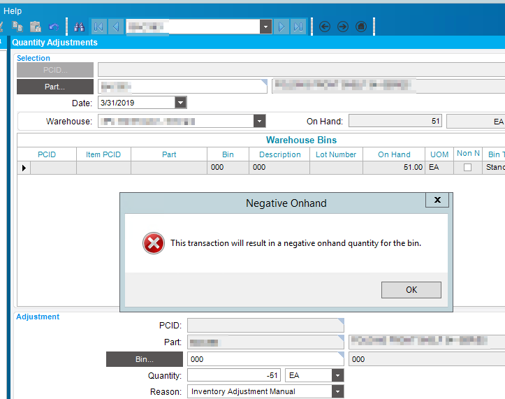

Hello!
Our logistics team is trying to zero out remaining inventory in a previous warehouse via manual inventory adjustments. When they are attempting to zero this sku out we are getting this message, even though the quantity on hand looks ok. 51 -51 = 0. What could be causing this issue? Everything shows 0 in part tracker for this warehouse. Thanks!

Did you try running the part transaction history tracker out to a future date of like 2999 to see if there were any future dated transactions?

I just checked that and we do not have any future dated transactions. We also ran the refresh part quantities and allocations process last night.

only the one bin?
And can you do a Qty Adj of 50.999999? (just to see if it is a 10th place rounding thing)

Actually, try doing a Qty Adj of -50. If it lets you, then it might be a rounding thing. If it doesn’t than the “other” thing driving it is obviously a qty of more than 1.

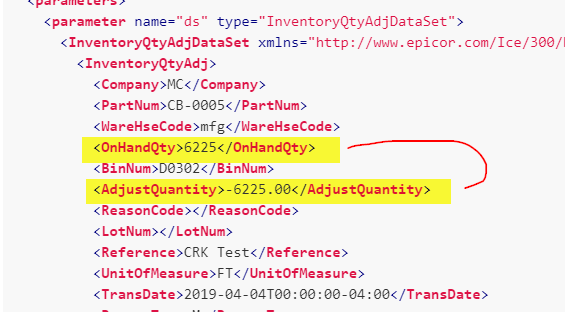

I enabled tracing and see that there is a Negative inventory Test method being called.
<tracePacket>
<businessObject>Erp.Proxy.BO.InventoryQtyAdjImpl</businessObject>
<methodName>NegativeInventoryTest</methodName>
<appServerUri>net.tcp://usdataps00122/MC-UAT/</appServerUri>
<returnType>System.Void</returnType>
<localTime>4/4/2019 14:44:40:7926334 PM</localTime>
<executionTime>146</executionTime>
<parameters>
<parameter name="pcPartNum" type="System.String"><![CDATA[CB-0005]]></parameter>
<parameter name="pcWhseCode" type="System.String"><![CDATA[mfg]]></parameter>
<parameter name="pcBinNum" type="System.String"><![CDATA[D0302]]></parameter>
<parameter name="pcLotNum" type="System.String"><![CDATA[]]></parameter>
<parameter name="pcPCID" type="System.String"><![CDATA[]]></parameter>
<parameter name="pcDimCode" type="System.String"><![CDATA[FT]]></parameter>
<parameter name="pdDimConvFactor" type="System.Int32"><![CDATA[1]]></parameter>
<parameter name="ipSellingQuantity" type="System.Decimal"><![CDATA[6225.00]]></parameter>
<parameter name="pcNeqQtyAction" type="System.String"><![CDATA[]]></parameter>
<parameter name="pcMessage" type="System.String"><![CDATA[]]></parameter>
</parameters>
</tracePacket>
Maybe check to see what value is being passed via the "ipSellingQuantity" param
also, the PreSetInventoryQtyAdj method includes the current QOH and the Adj Qty’s
<tracePacket>
<methodName>PreSetInventoryQtyAdj</methodName>
<localTime>4/4/2019 14:44:40:9475967 PM</localTime>
<executionTime>128</executionTime>
<parameters>
<parameter name="ds" type="InventoryQtyAdjDataSet">
<InventoryQtyAdjDataSet xmlns="http://www.epicor.com/Ice/300/BO/InventoryQtyAdj/InventoryQtyAdj">
<InventoryQtyAdj>
<Company>MC</Company>
<PartNum>CB-0005</PartNum>
<WareHseCode>mfg</WareHseCode>
<OnHandQty>6225</OnHandQty>
<BinNum>D0302</BinNum>
<AdjustQuantity>-6225.00</AdjustQuantity>
<ReasonCode></ReasonCode>
<LotNum></LotNum>
<Reference>CRK Test</Reference>
<UnitOfMeasure>FT</UnitOfMeasure>
<TransDate>2019-04-04T00:00:00-04:00</TransDate>
<ReasonType>M</ReasonType>
<SerialNoQty>0</SerialNoQty>
<TempSerialNo>0</TempSerialNo>
<ReasonCodeReq>false</ReasonCodeReq>
<AllowNegQty>false</AllowNegQty>
<LegalNumberMessage></LegalNumberMessage>
<StkUOMCode>FT</StkUOMCode>
<EnableSN>false</EnableSN>
<OnHandUOM>FT</OnHandUOM>
<TranDocTypeID></TranDocTypeID>
<PCID></PCID>
<SysRowID>00000000-0000-0000-0000-000000000000</SysRowID>
<PartTrackLots>false</PartTrackLots>
<PartTrackDimension>false</PartTrackDimension>
<PartSalesUM>FT</PartSalesUM>
<PartPricePerCode>E</PartPricePerCode>
<PartSellingFactor>1</PartSellingFactor>
<PartTrackSerialNum>false</PartTrackSerialNum>
<PartIUM>FT</PartIUM>
<PartPartDescription>Cable- KYNAR/HMWPE #8 20 mil Kynar / 90 mil HMWPE</PartPartDescription>
<ReasonCodeDescription></ReasonCodeDescription>
<WareHseDescription>Main, CHALFONT</WareHseDescription>
<WhseBinDescription>ROW D, SECTION 03, LEVEL 02</WhseBinDescription>
<RowMod></RowMod>
</InventoryQtyAdj>
</InventoryQtyAdjDataSet>
</parameter>
<parameter name="requiresUserInput" type="System.Boolean"><![CDATA[False]]></parameter>
</parameters>
<paramDataSetChanges>
<paramDataSet name="ds" useDataSetNbr="0">
<changedValue tableName="InventoryQtyAdj" rowState="Modified" rowNum="0" colName="BinNum"><![CDATA[D0302]]></changedValue>
<changedValue tableName="InventoryQtyAdj" rowState="Modified" rowNum="0" colName="AdjustQuantity"><![CDATA[-6225.00]]></changedValue>
<changedValue tableName="InventoryQtyAdj" rowState="Modified" rowNum="0" colName="Reference"><![CDATA[CRK Test]]></changedValue>
<changedValue tableName="InventoryQtyAdj" rowState="Modified" rowNum="0" colName="WhseBinDescription"><![CDATA[ROW D, SECTION 03, LEVEL 02]]></changedValue>
</paramDataSet>
</paramDataSetChanges>
</tracePacket>
check to see if these match

Let me check and see if we have any open packs for this sku. I also did run that same trace as well, and it stopped after the Negative Inventory test.

We have no open packs for this sku. I can’t adjust the quantity with 50. We purchase this part/don’t manufacture it so nothing in the job area.
