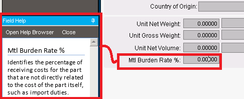

Not sure if this would apply in your case but… I remember one site that set up “Mtl Burden Rate %” on their part masters.
Also might want to look at “Material Burden” section in the Job Costing Tech Ref Guide. If you haven’t already noticed, the E10 help includes links to PDFs for the Tech Ref Guide(s).

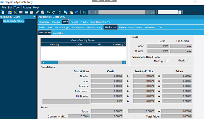

There is a worksheet available in the quote entry.
It may help your sales team to arrive at the final price.
