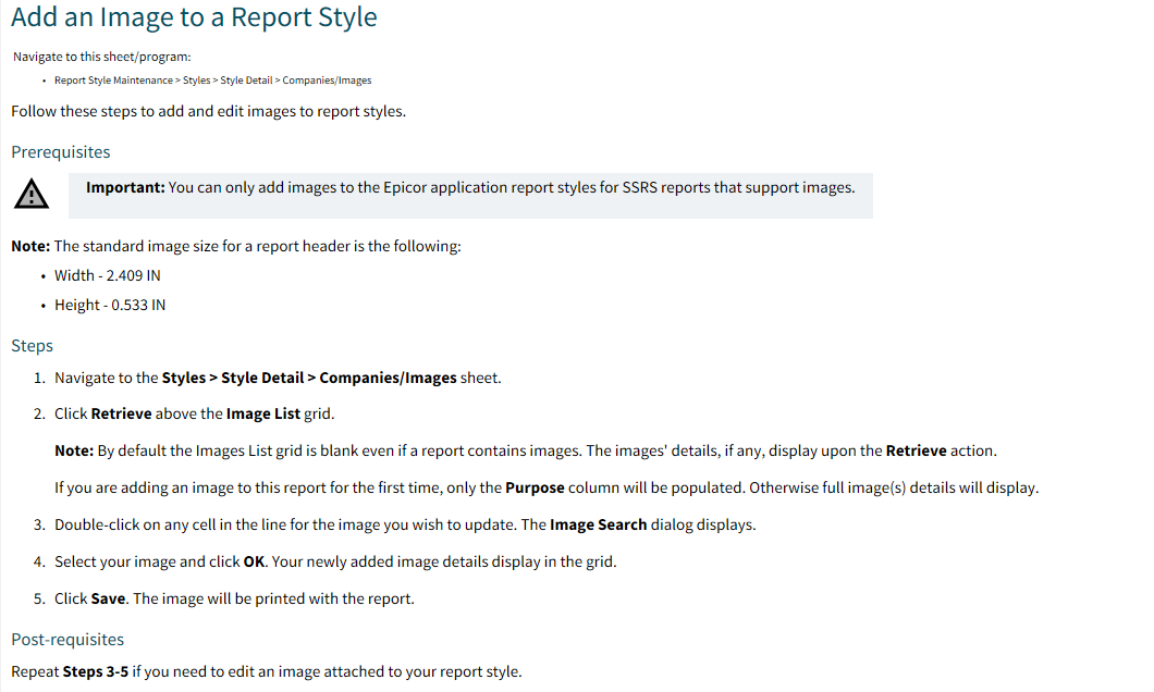

How do I add or remove logos to invoices and credit notes.
Go to Report Style
Create a new report style for your company
For your custom reports put them into the Custom Report folder
Open the Report (rdl) with Report Builder and modify the logo there.
Some of the forms (the AR invoice for sure) you can add a logo without even needing to create a custom report style. I see you’re on 10.2, pretty sure that functionality existed back then but not 100% sure.
I never liked the whole embedding because of multi-company and having to manage changes… I always just did the following:
