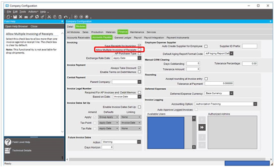

An Epicor Consultant guided us to this setting under the Company Configuration - Modules - Finance - Accounts Payable tab:
(We are on 10.1.600 - may not be in your version!!!)
Selecting that option now allows us to Invoice multiple times against a single Receipt line. :slight_smile:
AP Partial Invoicing
In the Accounts Payable module of Epicor ERP, you can enter more than one invoice against a receipt line. The non-invoiced quantity will be available for selection on future invoices and will be properly reflected on the AP Received Not Invoiced report.

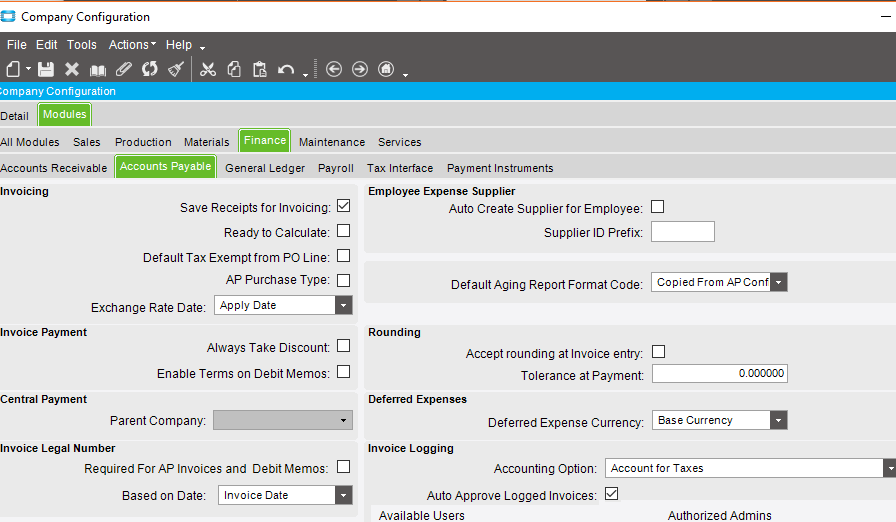

This sounds like exactly what I need to enable! But I don’t see it in my Company Configuration. We are on 10.1.2.400…I wonder if the setting is available elsewhere?

We are on 10.1.600
Alas!!! No checkbox either. I think I may have to make a support call, myself. We are obviously behind the curve on upgrading. I appreciate your help immensely.
Called support and they say this functionality is only available on 10.1.600 onward. There is no workaround. Just wanted to document that if anyone runs into same issue. Time to upgrade, I suppose.
