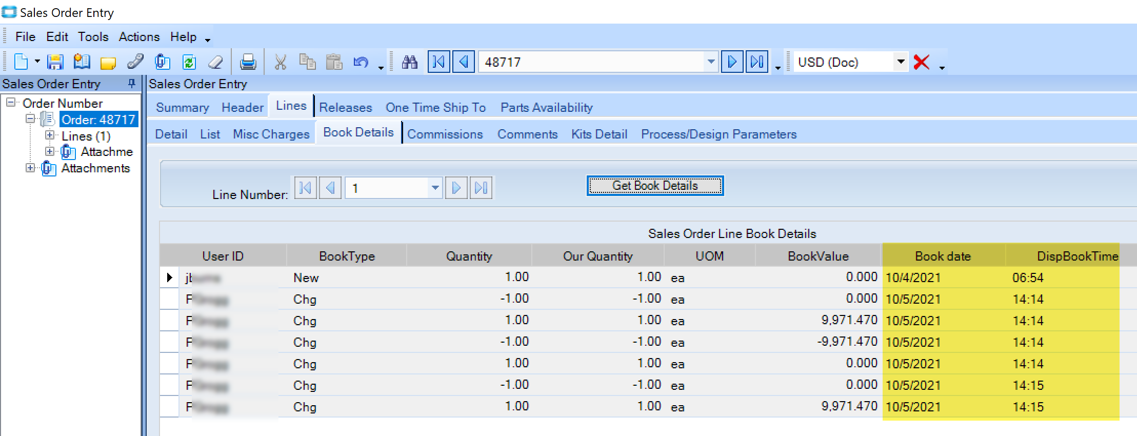

Book details would show when the line bookings were in there and when changed, etc., per below. This might help ascertain what might’ve happened.
Nancy
