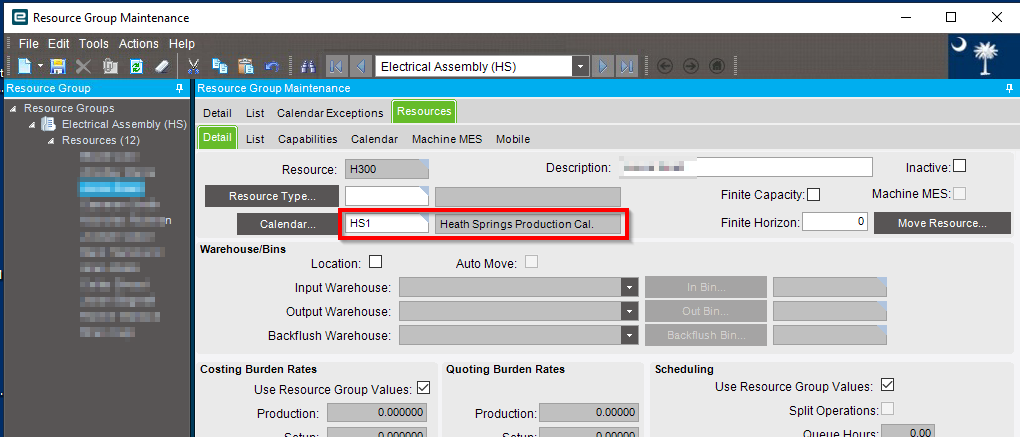

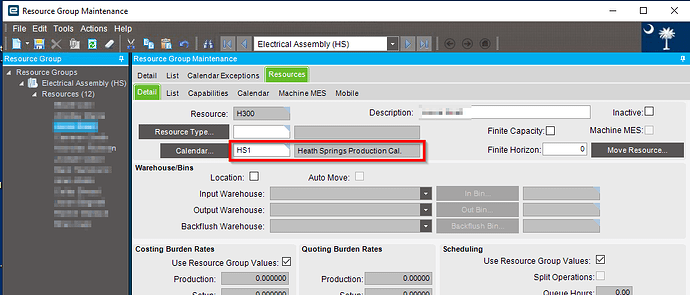

I believe you can assign a production calendar to a resource.
Even better, you can go into Resouce Group Entry and set group and resource-level exceptions to the main production calendar.

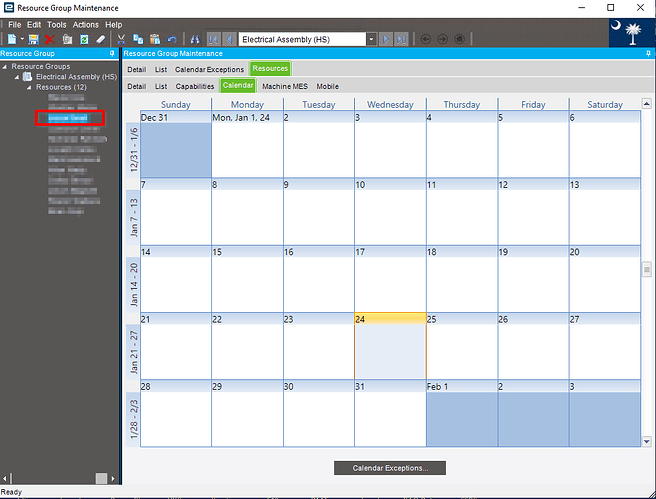

We set it at the resource calendar. We select the resource and move to the calendar tab to select the days the resource is away. We do set this for all employee vacations or leave of absence.
I went for the resource calendar exception route.
