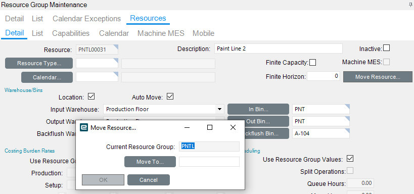

You can’t delete a resource once referenced but you can move it. (See Move Resource… button on right of Finite Horizon). Move the resource to the correct group or create an Obsolete RG and move it there.
I love that move resource button. First I setup all my resources in a temporary group, then moved them to the right group when I was ready. However, I can’t move this outdated resource, as there is at least one job that has now scheduled it. Is there a way to unscheduled everything, so that I can move that resource, then regen capacity, and run global scheduling again?
