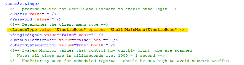

Edit your config file to launch as “KineticHome”
Example:

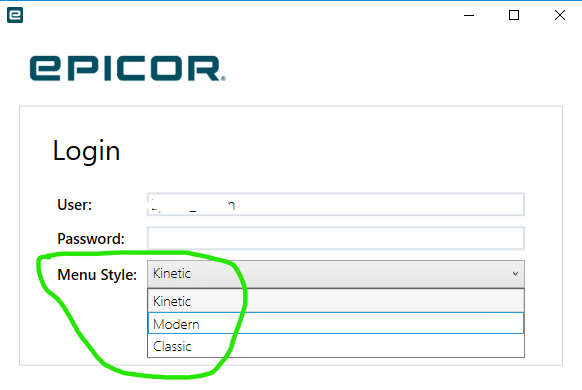

Tried your suggestion but it does not seem to do anything, user can still use the drop down to select a different home screen, I want to remove these options from the drop down if possible.
I think you may need to adjust the sysconfig file on the deployment server instead of the client. The client updates the sysconfig every time it launches, so it may be getting overwritten.
don’t know if I’m doing something wrong but it’s not making any difference to the log in prompt, can still select other options.
tried updating both the config in the deployment share and the one on the client machine.

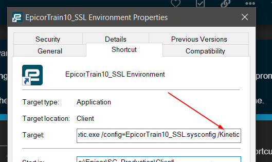

Change the shortcut (desktop shortcut) append
 /Kinetic
At the end of the shortcut
Nope, does not stop the user using the drop down and selecting classic or modern. Also, that solution does not scale or stick, having to modify everyone’s shortcuts.

What we want is for that drop down to contain one option, Kinetic and nothing else, with no way the client user can get around it.
