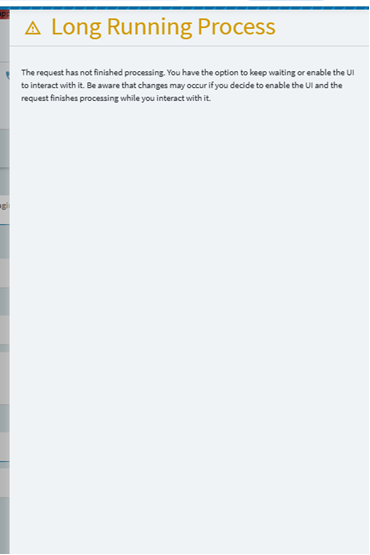

Kinetic is very slow for us right now, and I was wondering if any other Cloud users are seeing the same thing. It is taking very long for landing pages to load. I am clicking the + for new quote and nothing is happening. Many users are getting a Long running process message

For example, i just refreshed the browser for the sales order entry page. It took 20 seconds for it to render and another 55 seconds for the grid of the landing page to populate with default number of rows (i think its around 400).

We had an issue like that yesterday afternoon for an hour or so. Any update in every app was taking forever. Correlation errors pointing to SQL timeouts and getting the long running process message.
