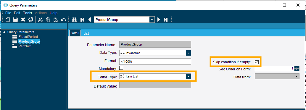

Because this is a Report based on BAQ, I was able to filter there by utilizing the Table Criteria
while the parameter is set up like this
This way, I don’t need to bring these filters over to my RDL, the results are being filtered in BAQ before they get forwarded to RDL.

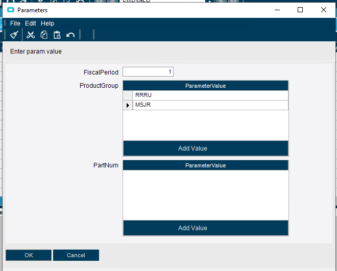

did you have to manually type out the list that they can select from?
NO, in the BAQ when you test it, it comes up like this

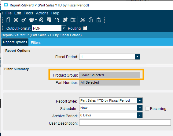

but the report itself uses its filters
It all falls into place and works like a charm.
With a one but, in this report, I don’t need to show any summary of these filters on the printout itself. If that would be needed, I would have to extract the names from your method.
It just takes in the user selected filters, passes it to BAQ and returns filtered rows.
