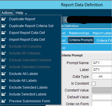

Although I really wish the RDD Actions Menu had a Test Report Form option like in the BAQ Report Designer:

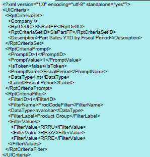

Ms. Heather: I see my Criteria in the RptParameter table in a Field called UserCriteria. Unfortunately, it is in XML - so you would have to parse the tags. My Criteria is called FormatID
<?xml version="1.0" encoding="utf-8" standalone="yes"?> FormatMiscInfo FormatID FormatID 1 401787 false FormatID nvarchar FormatID
Hi Dave, thank you for the response! I actually did see my Criteria in the RptParameter - UserCriteria field and I was afraid someone was going to say I would need to parse it out. Cringe :grimacing: Well, at least it’s there but I would say that it would be really nice if Epicor could design each Report Criteria Prompt to come through as individual fields. So maybe I’m only 98% sold on this way of creating reports. :wink:

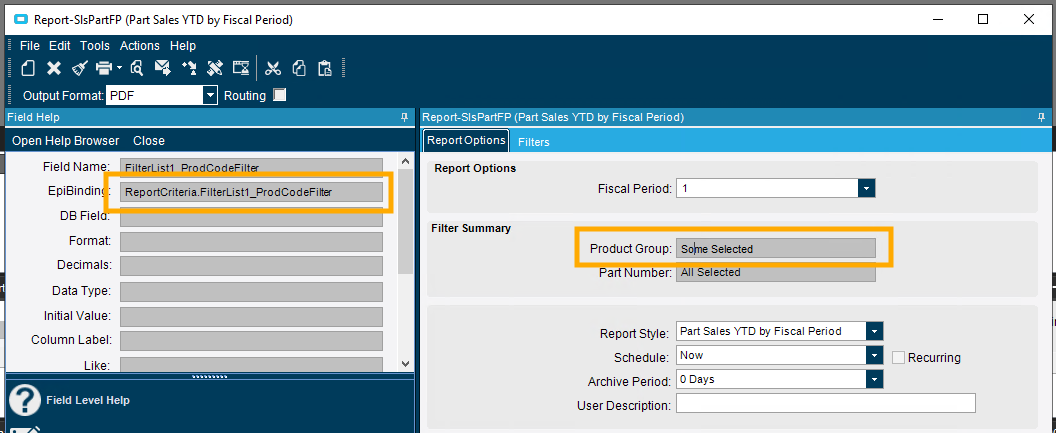

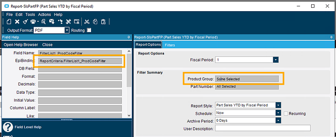

I’m hitting a wall here. You are showing how to extract the Prompt out of the XML of the UserCriteria field.
What do you do about the Criteria Filters that live in the same field. I get an error if I put my Filter Name instead of the Prompt Name in this formula. Please see my example:
Monika. Look at the dataset in your RDL for the reportcriteria prompt 1, do you see it?
I don’t see reportcriteria dataset in my rdl
You are right this field points to ReportCriteria.FilterList1_ProdCodeFilter but I have no idea where to find it in my rdl.

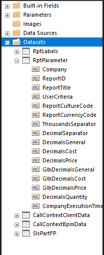

Look in the dataset RptParameter, do you see a filter list 1? I think what you’ll see is a big XML string.
This thread has some info: RDD BAQ PARAMETER - Parse XML code - #11 by utaylor
that’s all there is in my RptParameters
