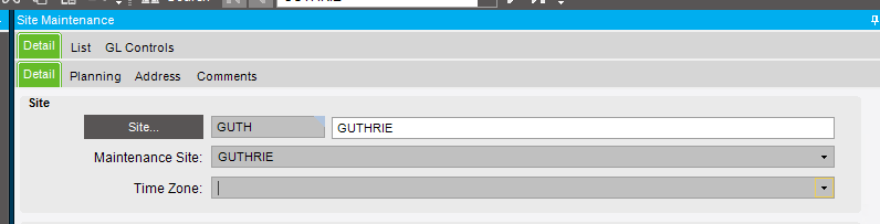

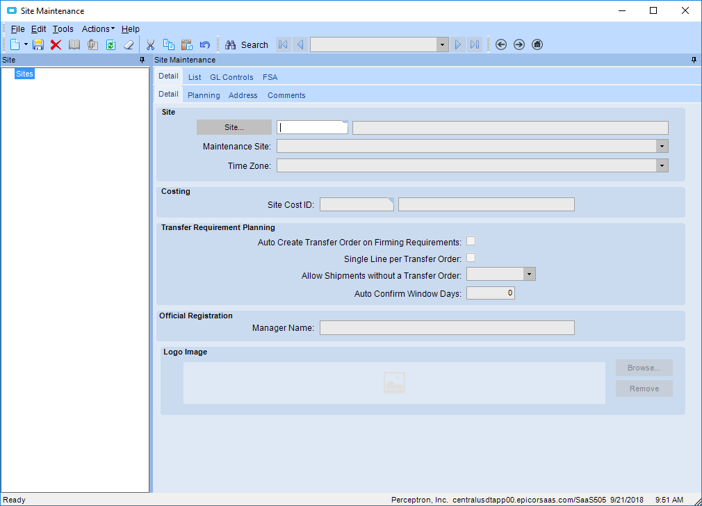

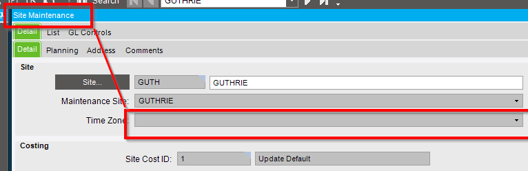

FWIW - We use multi site, but are unable to set the timezone - it is grayed out.
The help says that Time Zone Offset in Site Config is now disabled, and to use the Time Zone drop down on Site Maint.
Here are mine…
and
The opposite of what the help says.
