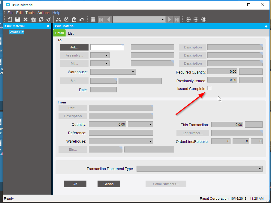

You can use the
Material Management -> General Operations -> Issue Material
But the Job has to have at least one Material assigned, then you can issue any parts that you use to that Mtl Seq.

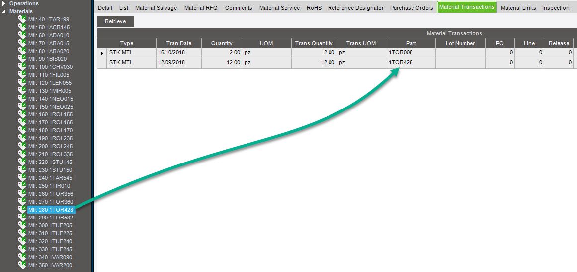

To view what has been issued to the job, use the Job Tracker and look under Job Details -> Materials -> Material Transactions.

I have already tried to issue material that is not in the material list of the work from Issue Material, but it only allows me to issue materials that are in the work list.
Yes, you select a material that is in the list first in the TO section.
And in the FROM section, you can use any parts… For example, workers should be allow to choose what materials for the job.

Thank you very much, I just issued the material that way and if you allowed me.
I was hesitating because the description of the other material continued to appear but if the material that is selected was issued.

If you look in job tracker, under material transactions, you can see that the other material was issued. The required material on the job still stay at the original part number.
Just curious … Does issuing an “other” material to a job add to the Qty Issued, and potentially set the Issued Complete flag?

So does the “Issued Complete” flags get set on lines 10 and 20?
Or does the system only add to the Issued Qty (and set Issued Comp flag) when the originally specified P/N is used?
You can control that check box when you issue the material. It will automatically check it if your qty is above the required, but you can uncheck it if you wish. I’d have to test to see what happens for the second issuing of material.

In our case, the work requests the material 1TOR428 but in storage all the necessary pieces are not in stock, for that another material is issued that is similar that is 1TOR008.
It does not appear in the list of materials requested by the work, but it is reflected in the work material transactions.
