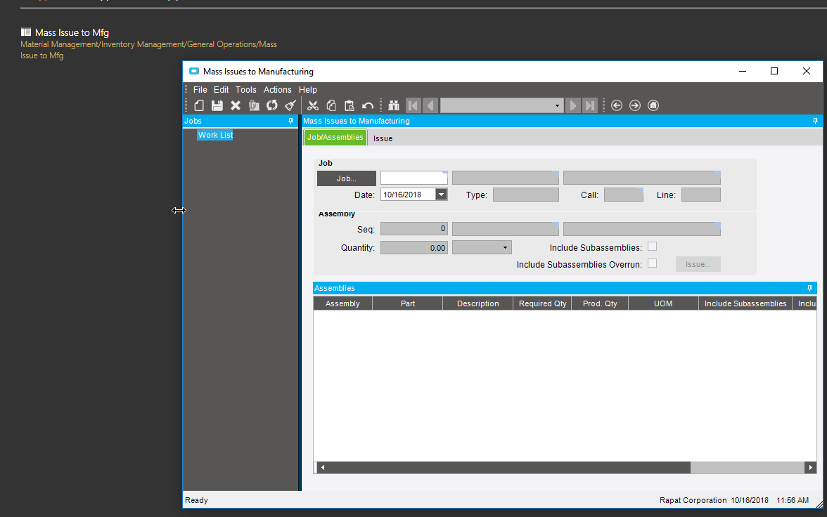

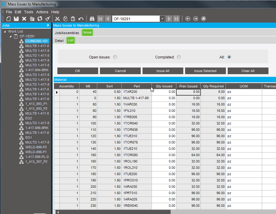

This is the screen. I forgot you are implementing. You will have to decide how you issue materials to a job. Backflushing will automatically issue the required material when the related operation is completed. Manual, would be one at a time (the screen I’m pretty sure you are already using) and mass issue, is a way to issue everything on the job at once.
Backflushing and Mass issue are going to rely on the Job matching what the shop floor is actually doing. If they follow the instruction on the job, you can save a lot of time on transactions.
If you want to have the freedom to substitute at will, you have to tell the database somehow what you used. That’s where the manual issue comes in.

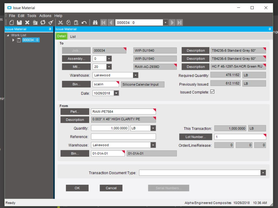

I have already used the screen, in fact it is the way in which we supply the material, but the worker manually enters the amount that will supply the material that is required, in case it is going to issue the whole quantity or only a part.
It is correct, it does not show the information very clear, that is why we show more columns to be able to observe more information when issuing the material.

I am interested in this answer. We are implementing 10.2.200.8. Our floor supv wants to know if we can substitute materials on the fly w/o using job entry. EPICOR support doesn’t have a fix.
When you go to issue material to a job, you first enter the Assy# and MtlSeq#. The screen then autofills the PartNum with the one specified on the job. You can change the PartNum to a different one, as long as the UOM are compatible.
For example, if the job calls for 10 OZ of EPOXY-001 (which has a UOM class of volume), you change that to 300 ML of ADHES-543, if it also has a UOM class of volume.
If GLUE-123 had a UOM class of weight, you would not be able issue it against the MtlSeq for the EPOXY-001.
