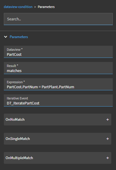

I think it would be helpful to see your dataview-condition configuration - and your iterative event - so we can see what might not be getting updated.

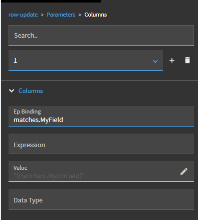

It’s pretty basic (which is probably the problem).
Dataview Condition
Iterative Event
Your Expression in the dataview-condition is the problem.
This takes each row of PartCost and is testing its PartNum value against the PartNum of the currently-selected row of PartPlant (so you always get the same Plant)
Let me see if I can find a better expression…
I tried adding a AND PartCost.PrimaryPlant CONTAINS(Because of the damn ~) PartPlant.Plant. This only populates the one row that is the current plant and leaves the others blank.
As far as the BPM suggestion goes, I wouldn’t mind going that route but the field that is being filled in on the PartCost is just a field that has been added in the dataview and not actually added to the table. I’m not sure how I would go about populating it through the BPM.
I reviewed the walkthrough you are following and see that the expression should be fine - it’s on the dataview-filter-set of the iterative event where the selection is applied
What does yours look like?
