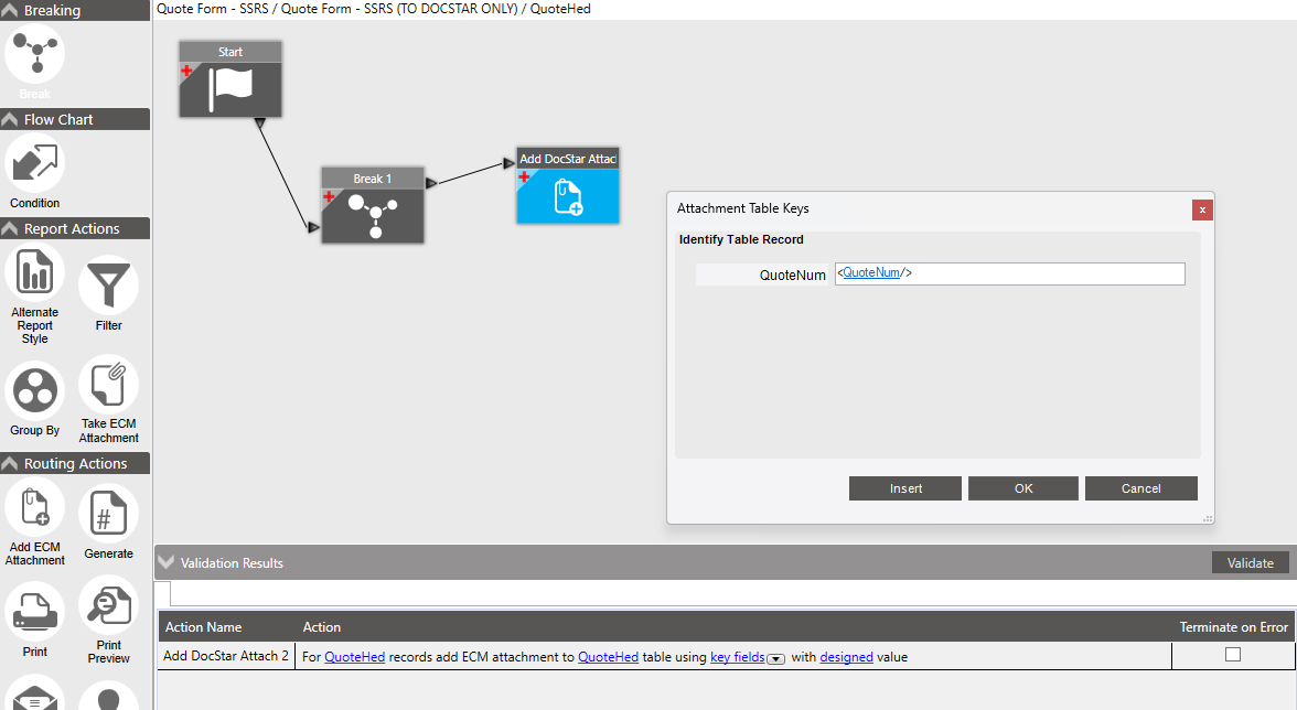

That is correct, you have to use variables to populate the Email To field (among others).
I can’t even get ours to Route to our Dev ECM site, you have to use Variables to populate the Identify Table Record in the Add DocStar Attachment

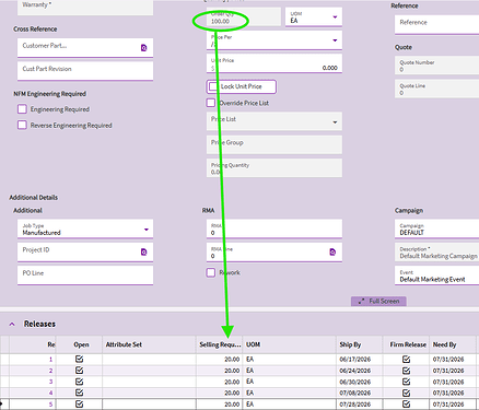

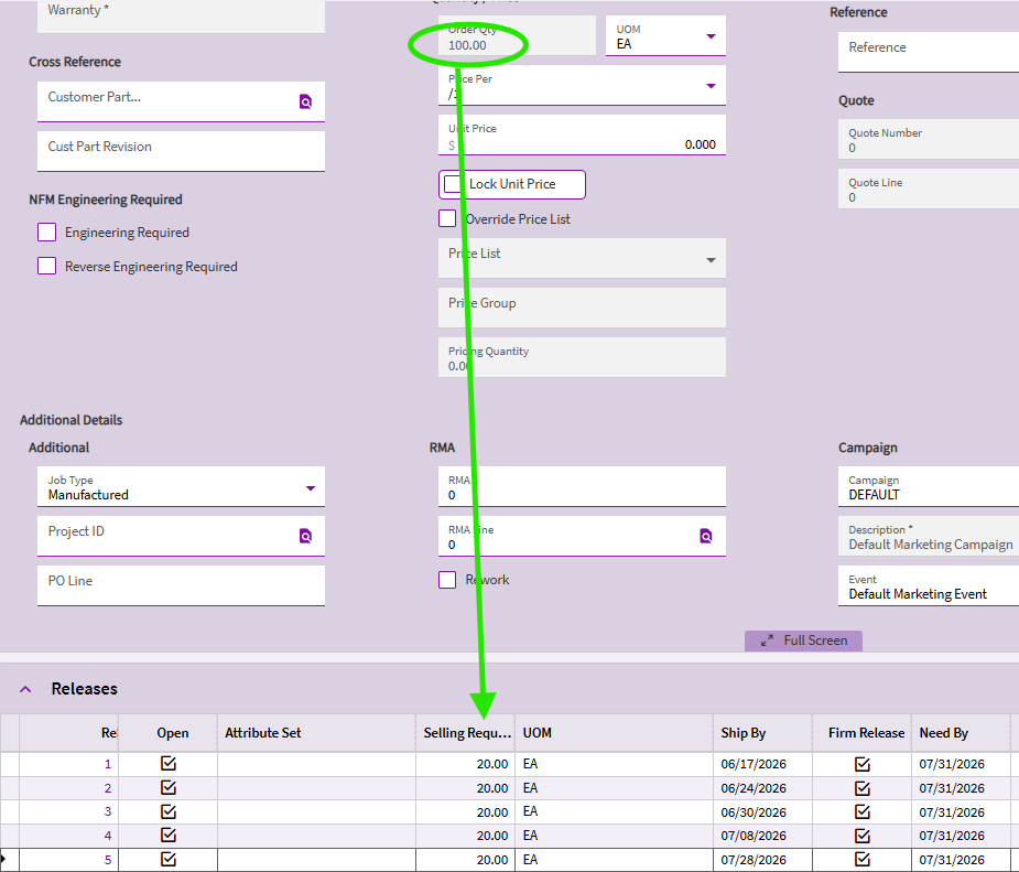

Can add a line to a sales order just fine. Say for 200 units. We then break those 200 units down into actual releases, i.e. instances of 20 per release. That functionality appears to be broken. They’ve confirmed it, so just waiting on a resolution now…
What’s the error?

Not seeing any issue adding multiple releases:
What did they confirm? Are there any nuances to how you’re doing this? It seems to work for me.

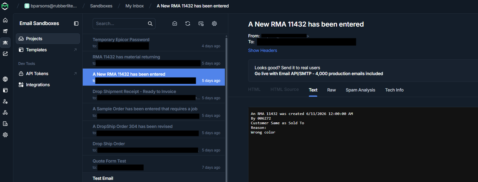

I can confirm that our basic BPMs that email, even with Variables, do fire and email out.
These do not Route documents. That seems to be the underlying culprit for us with our errors and failures.
They’ve come back to me. Looks like there’s a BPM on the OrderRel table which is causing it. It’s one that Epicor Professional Services put in when we went live years ago, so that’s a nice fun one to sort!

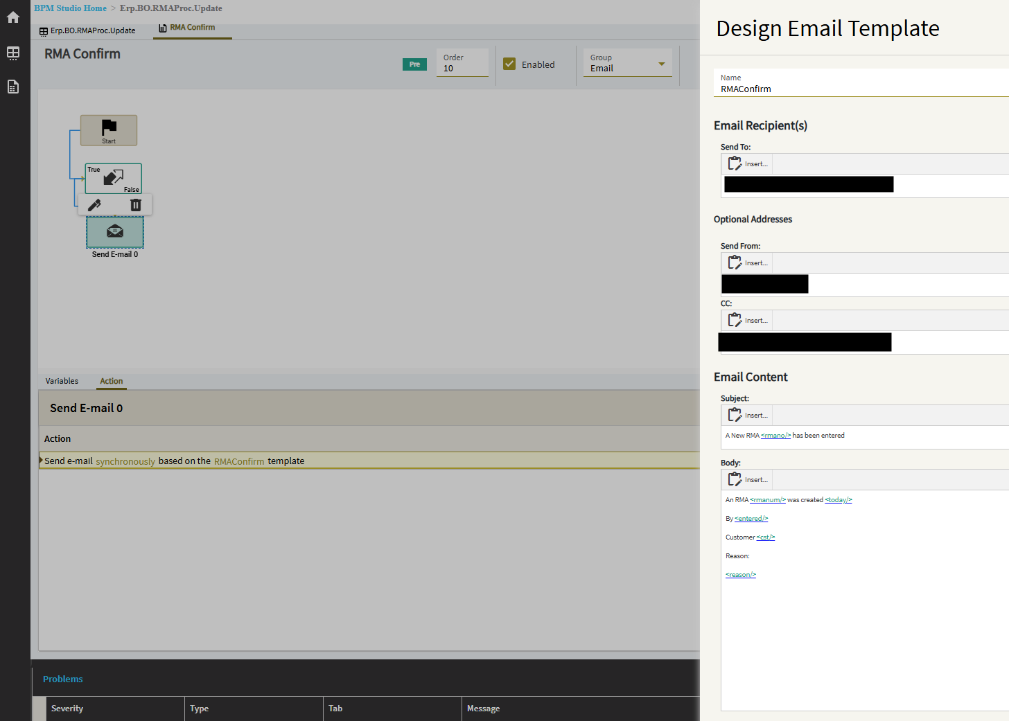

email only fails when it is asynchronous.
I was about to say, I’m pretty sure you have a customization hiding out!
