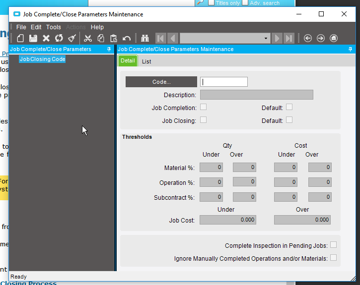

I would like to jobs to auto-close as soon as we make 98% of what we were supposed to make.
But I don’t seem to find the correct “Job Complete/Close Parameters” to accomplish that. I added the code to the product group, completed all the operations but every time, I get the “This Job has parts in WIP” error message in the “Job Closing Exception Tracker”.

There are thresholds/tolerances that you can set somewhere. Did you find those?
Yes but I don’t seem to find the right parameters that will close my job when I made 98% of what I was supposed to make. What values would you put to achieve that goal?

the parameters are on material and labor variances that are acceptable. if you are short on the completed quantity then i don’t think the auto will work. We run auto completion first then auto closing.
There is a process that i have never used called production yield recalculation that could adjust your jobs quantities and then completion and closing would work.
From Epicor help.
Adjust Job Quantities
Determines whether you want the application to automatically apply a quantity adjustment to a job that results from the Production Yield functionality. This feature automatically recalculates production quantities on operations that are above or below the original job estimates.
