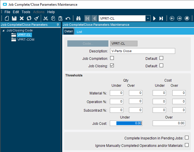

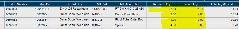

When running the Auto job Closing Process, when it looks at the Parameters setup, if the Parameter is set to 0, does it ignore that parameter, or does it then only do the auto closing/completion if it matches exactly? I am seeing jobs being closed wit material quantity mis-matches, where it does not seem to be catching those situations. A lot of times it seems to be over-issued material.
0 means close with ANY variance. We want to be able to auto close jobs only when there is NO variance, but the program doesn’t support it. If that is what you are after too you can vote for my idea.
https://epicor-manufacturing.ideas.aha.io/ideas/KNTC-I-2520
