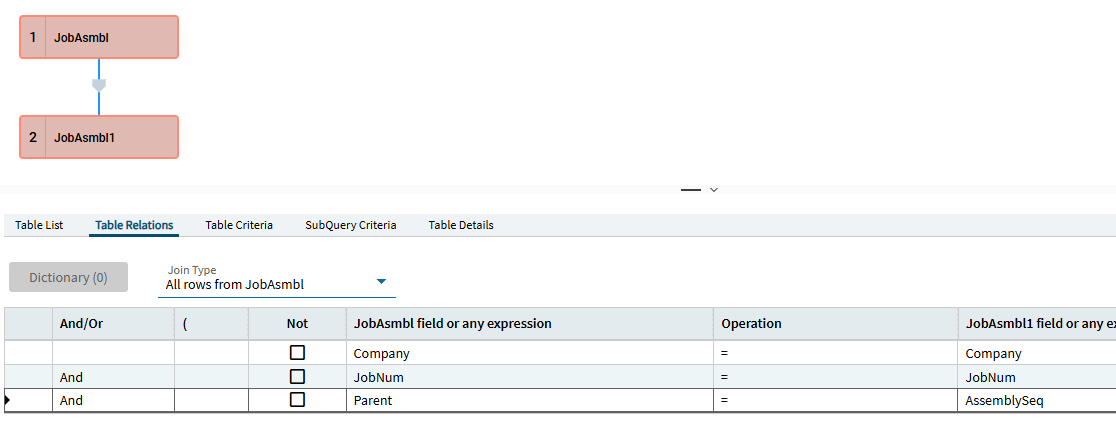

In my previous post (linked above) I created a simple BAQ, just querying the JobAsmbl table. I’m going to use the same BAQ, but I’m going to add some detail to help the user decide which instance of the PartNum they might be looking for. You can add MORE to this BAQ… as much detail as you want… but I’m still keeping it simple at this point.
So, starting with the existing query with the JobAsmbl table:
I’m just going to add the JobAsmbl table again. Setting that join to include all rows from the original JobAsmbl table (Left outer join). And then adding the table relationships of:
Company = Company
JobNum = JobNum
Parent = AssemblySeq
For Display Fields, I’m choosing the below:
This at least gives the user a few little breadcrumbs when they search for an assembly PartNum, they’ll see the Parent AssemblySeq, the Parent PartNum, and Parent Part Description. Again, if it is helpful for your users to see additional info… add more detail as needed.

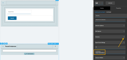

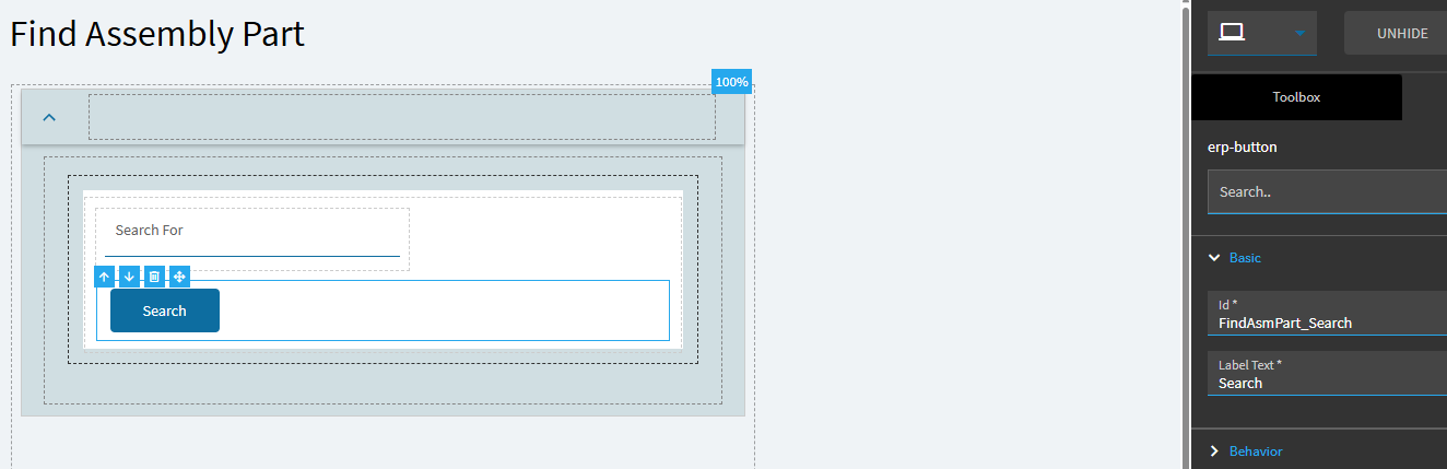

We can just build off the existing page Epicor provides. Edit the Find Assembly Part page and we need to add a button and a panel card grid.
The button is pretty straight foward:

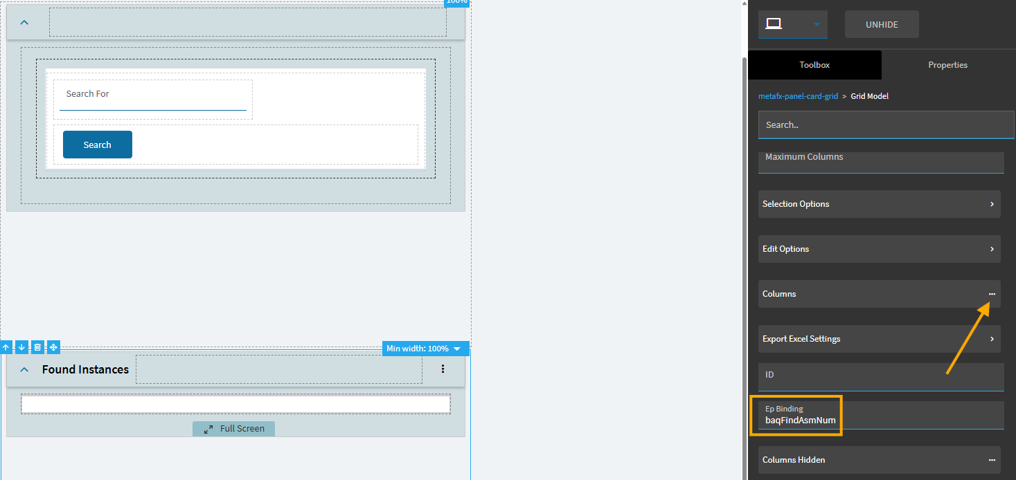

For the panel card grid > Grid Model
We want to bind this grid to our BAQ dataview, and then you can create the corresponding columns.
Save when complete.

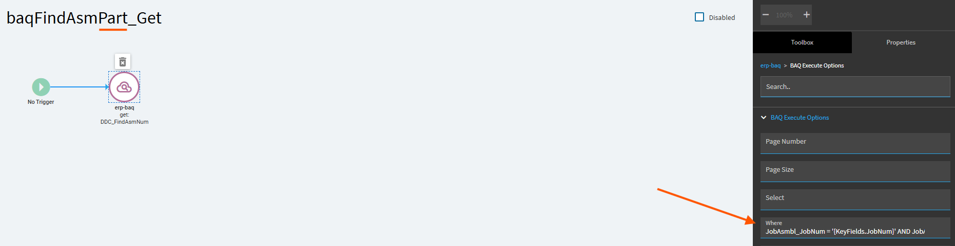

EVENTS - Number (1) - BAQ “Get”
First… depending on whether you did the previous post’s customization or not, we need to either modify the BAQ “get” event, OR, create a new one.
In the original post, my “get” event used the below where clause:
JobAsmbl_JobNum = '{KeyFields.JobNum}' AND JobAsmbl_AssemblySeq = '{TransView.FindAsmNum}'
This worked because we were using our new “Find Assembly NUMBER tool” and feeding it a JobNum and an AssemblySeq.
For THIS tool, we need to feed it a JobNum and a PartNum.
So, if you didn’t do the previous customization… you can just change your get event to include the below where clause (in BAQ Execute Options).
If you DID do the previous customization… you’ll want to copy the original “get” event, rename it, and then use the below where clause. That way, depending on which “tool” you’re using, you’re passing the BAQ different input variables.
JobAsmbl_JobNum = '{KeyFields.JobNum}' AND JobAsmbl_PartNum = '{TransView.PartNum}'
That is what I did in this case… copied the “Get” event, renamed, pasted in the new where clause:
So, I now have two different BAQ “get” events depending on which tool I’m using:

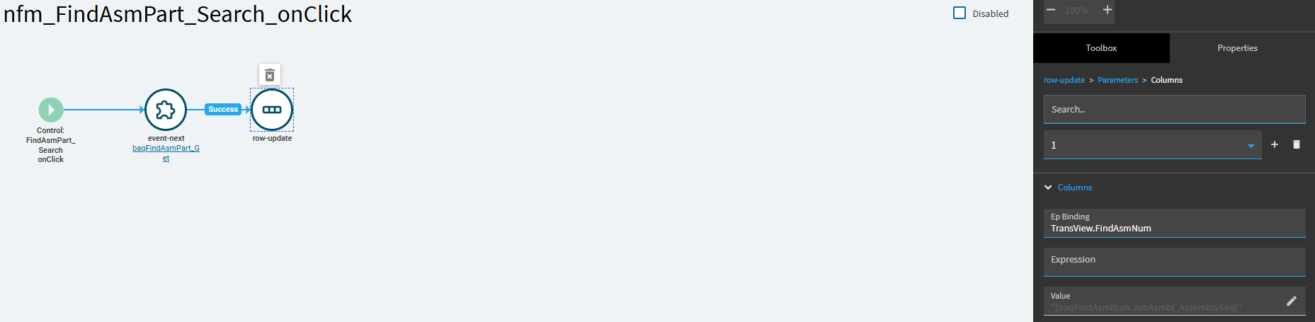

EVENTS - Number (2) - Search_onClick
For our next event, go back to your Find Assembly Part form click on you button, and in Properties > Behavior > select On Click
In this event, we’ll call an event-next targeting our 1st event (to run our BAQ).
OnSuccess, I added a Row-Update. Here I created a “helper column”. It may not be necessary in the grand scheme of things, but while troubleshooting downstream issues, I started using this helper column and since it works… I’m gonna run with it.
row-update: TransView.FindAsmNum
Value (JSON): "{baqFindAsmNum.JobAsmbl_AssemblySeq}"
So, with this event, on the Find Assembly Part page, the user will enter a part number. When they click the Search button, we are going to run our BAQ AND pass the returned baq JobAsmbl_AssemblySeq value to our helper column. If your BAQ returns multiple rows (which it may… that IS the point of this customization) it will assign the value of the first returned row.

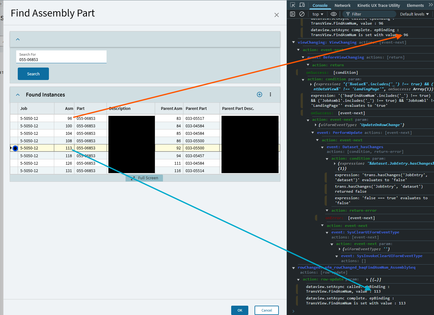

EVENTS - Number (3) - BAQ DataView - rowChanged
The next event, just create from scratch. The previous event sets our helper column to the first AssemblySeq value after our BAQ runs. BUT… if the user selects a different row in the Grid, we need to update our help column’s value.
Trigger:
row-update (same as the last one):
Finished event:
PREVIEW… thus far…

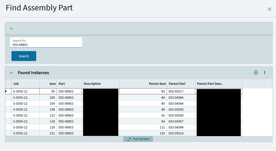

You should be able to enter a valid assembly PartNum and click search. Your grid should be populating.
In the below example, you’ll see our helper column was first assigned a value of (96) as that is the first returned row in my BAQ results. But I then clicked in a different row, and you can see my helped column was successfully updated to (113) by the rowChanged event.
So far, so good.

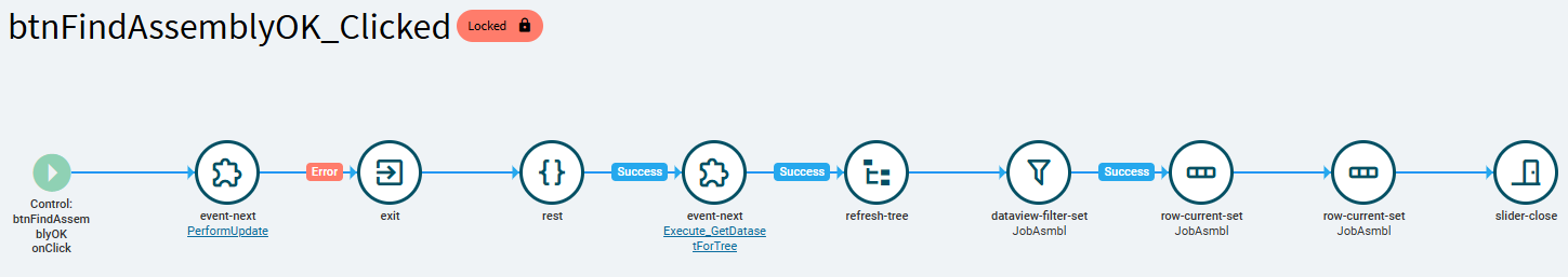

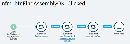

EVENTS - Number (4) - btnFindAssemblyOK_Clicked (override)
Epicor has an event with the above name. This event performs a rest call to the JobEntrysvc FindAssembly method. This method is lacking and will only return the first instance an assembly PartNum is found in the tree. Not good enough!
So, we’re going to bypass this with our own event.
I attempt to copy and modify the stock event for a LONG time and fought it every step of the way.
Here’s the base event:
Here’s my final version:
Trying to do everything in one long event chain was causing me issues. Ultimately I found I had to break this event into several smaller ones.
The Issue I encountered... if you REALLY want to know.
The issue I was seeing during testing, I simulated a user selecting a particular AssemblySeq, the tree updated and loaded the selected Assembly. BUT, I then tested the user immediately thinking, “crap, that’s not the assembly I wanted.” So I ran the events again, choosing a different row in my grid.
The event flow (as is) would store the AssemblySeq value from the first pass… and even though I changed the value in my second pass, it used the original value in the dataview-filter-set action, which caused the tree to not refresh to the desired (second selected) assembly.
I found that breaking the refreshTree into its own event forced the dataview-filter-set to pick up the new/updated AssemblySeq value.
Because we want to break this “OK_Click” event into smaller portions, I first attempted to make copies of the original event and hack them up… but I kept running into issue.
Honestly, instead of copying, its easier to start from scratch.
  • Create a new event
  • Change the name (I mimicked the original Epicor event name)
  • Set the trigger to override the stock event

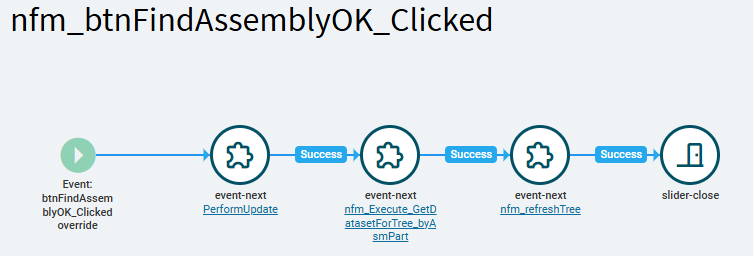

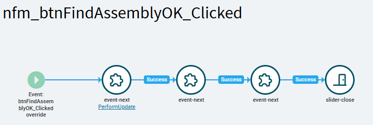

  • Add (3) event-next actions and a slider-close. (I made these all onSuccess of the preceding action.)
  • Update the first event-next to PerformUpdate.
Event (4) Layout (thus far):
Save (for now… we’ll come back to this event).

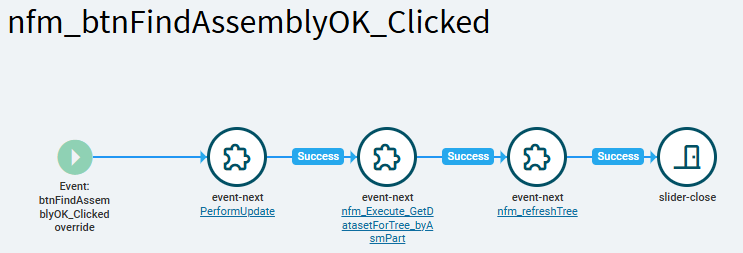

EVENTS - Number (4 - Revisited) - btnFindAssemblyOK_Clicked (override)
Update your 2nd & 3rd event-next actions to call the events we just created (events 5 & 6 above respectively).
Save. Done.

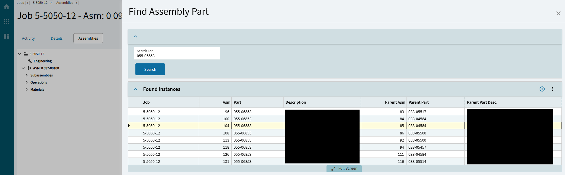

Preview time! - RESULTS!!

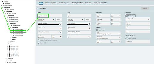

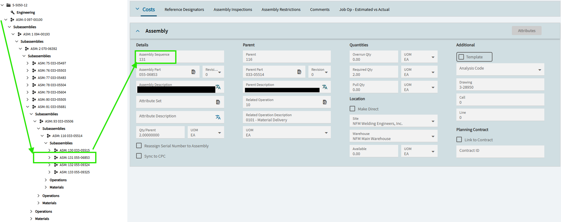

Clicking the Find Assembly Part tool… again, base functionality would default my tree to opening Assembly (96) - the first instance this PartNum appears as an Assembly PartNum.
Now, with the customization, I have a grid of all instances that PartNum appears as an Assembly PartNum.

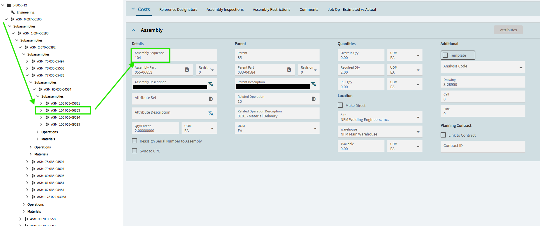

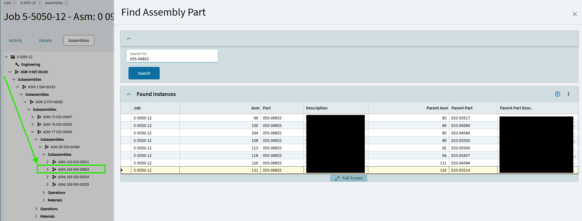

I’m selecting AssemblySeq (104), instead.
My Job Tree refreshes down to the level of AssemblySeq (104):

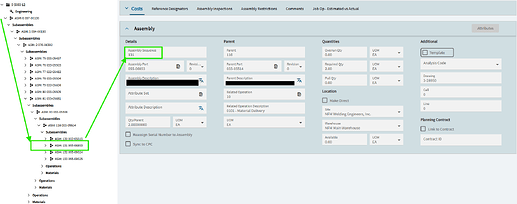

With my tree already expanded to my previous selection of (ASM 104)… I can re-run the events and choose a different assemblySeq (131 in this case):
Click OK… the tree refreshes and is now expanded to ASM 131:
