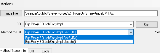

Using the trace log, if I unfirm a job manually I get
Which makes sense, although it’s not clear why it always calls Update() twice.
If I trace a DMT unfirm it’s much simpler:
This makes even more sense.

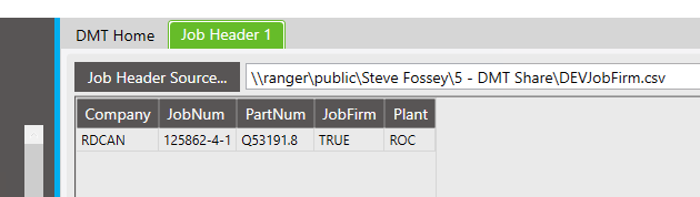

Using DMT, there’s no problem firming these jobs. I only have five columns:

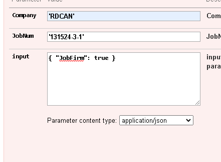

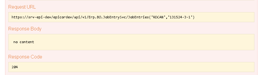

If I use REST in the Swagger UI I can firm jobs. It doesn’t work if I try to work in a different site to my last activity, but I gues if I was using Rest I’d specify that in headers.

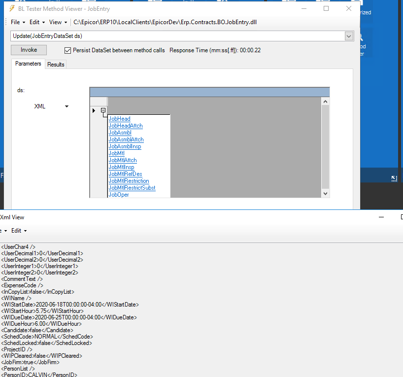

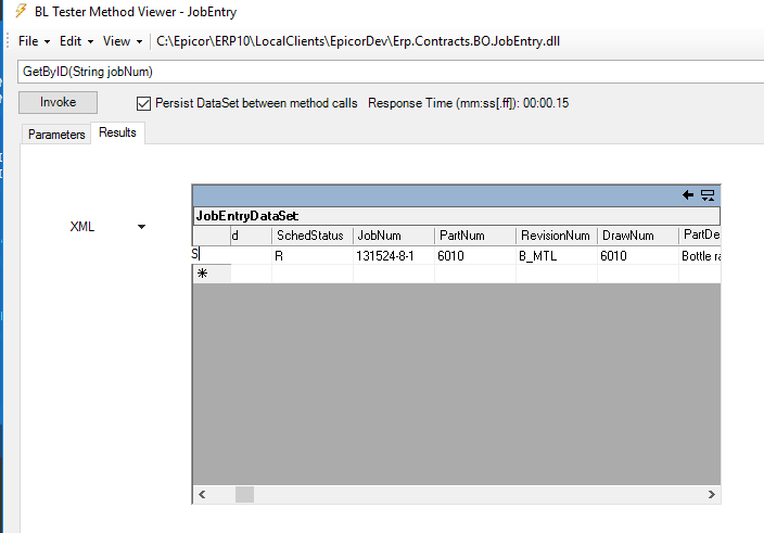

If I use the BLTester, with only GetByID and Update, everything just works.
I’ve managed to make it fail in BLTester two ways:
  • If I don’t set the plant using Tools > Change Plant before invoking GetByID
Or
  • If I make the change to the dataset AFTER pulling up the Update() method (but before invoking it).
That’s of interest because it gives me the same error as I’m getting in my BPM: “Update not allowed. Job not firm”. So if I select the Update() method and then change the dataset, I get this error, but if I change the flag right after GetByID() and THEN select Update() and immediately click Invoke, everything works.
The other thing I notice in BLTester is the JobFirm flag has 3 states. One click and it’s ticked, one more click and the tick turns grey, and one more click and the tick mark is cleared.
