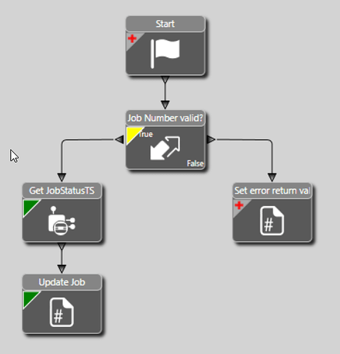

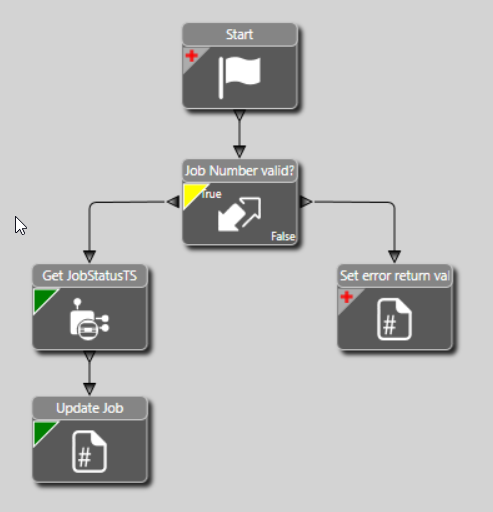

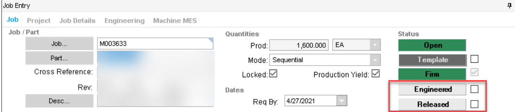

I am trying to recreate the functionality available in Job Status Maintenance in an Epicor Function. My function is as follows:
The first step (Job Number valid?) verifies the job number passed in exists. If it does, I run JobStatus.GetByID() and use the returned dataset to attempt to update the needed values. I have captured separate traces on Job Status Maintenance for when a job is firmed, released, or engineered

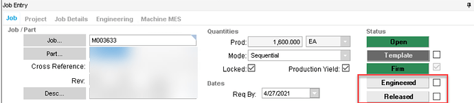

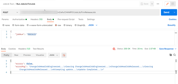

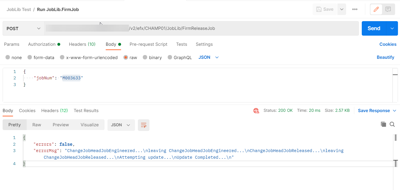

I run this method in postman and it appears to run… but the job isn’t released or engineered:

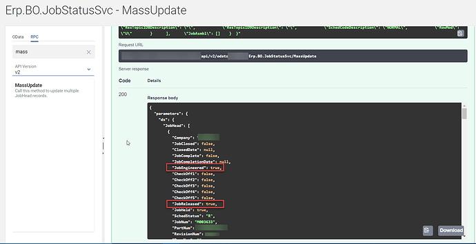

My next step was to remove my function from the process entirely. I invoke the MassUpdate method via the REST API v2 help page. When I run it here, I get the same results - a 200 response but the record isn’t actually updated.

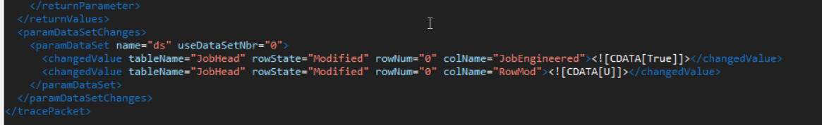

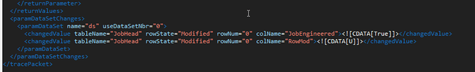

To the best of my knowledge I am. I am making the changes to the fields as shown in the trace log. Take the “Job Status - Job Engineered” trace for example. The fields that change between ChangeJobHeadJobEngineered and MassUpdate are JobHead.JobEngineered and RowMod
In my custom code block I set these two fields before running ChangeJobHeadJobEngineered
