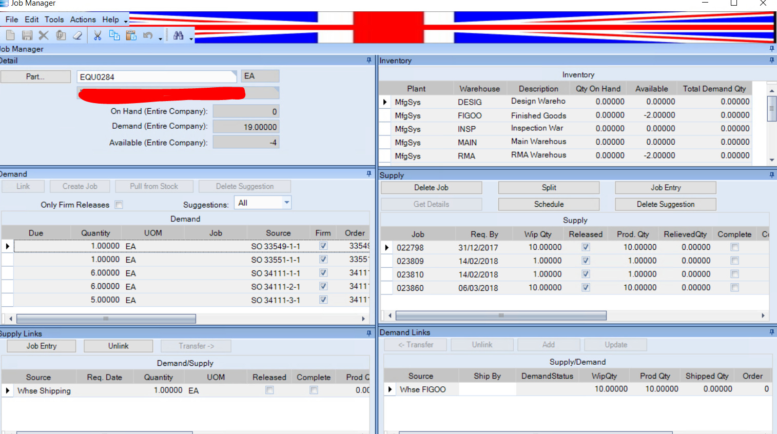

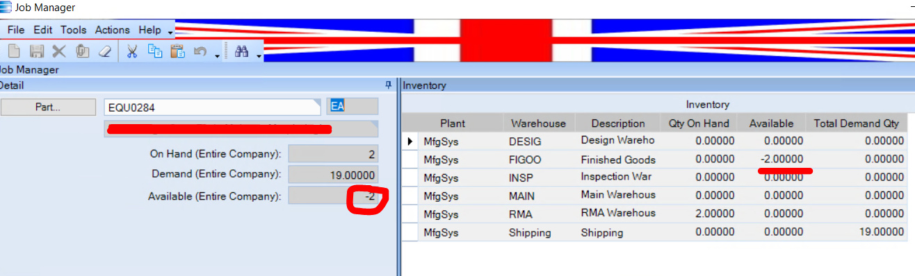

Job Manager shows -2 available stock in our finished goods warehouse.
Part Tracker is absolutely fine…
Where is this -2 coming from?

Is there a demand for 4 EA floating in the ether?
I see. I also note that now you also have an RMA WH showing -2. And total available is -4
yes - i guess that is because transactions are still occurring.

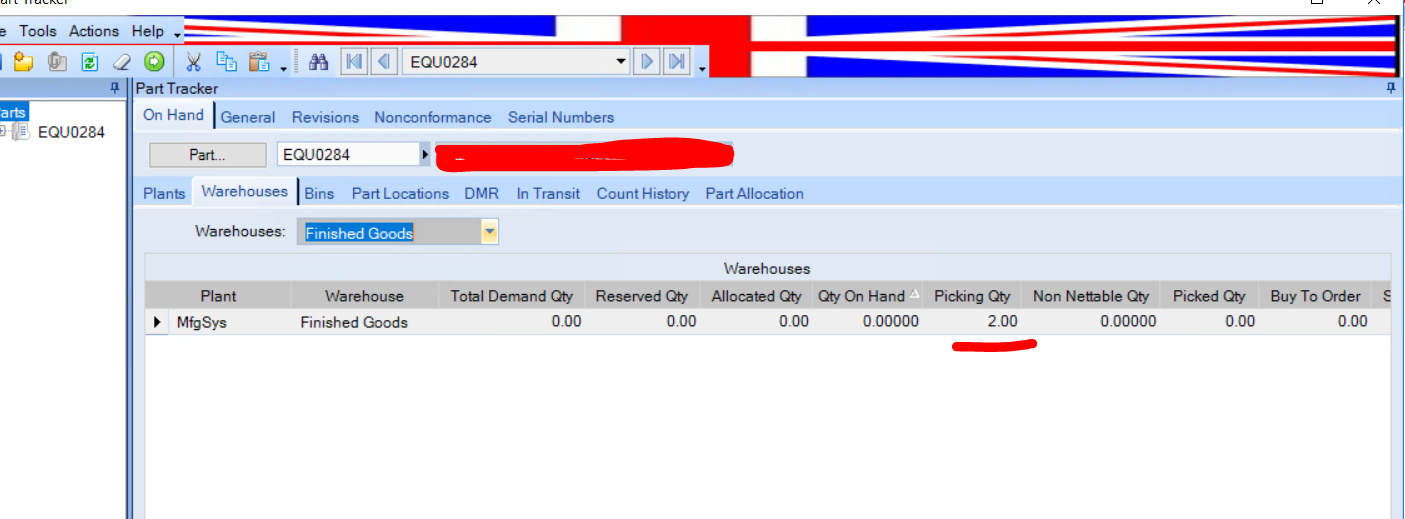

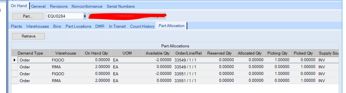

Any allocations? What you see under part locations in tracker?
this might explain it…
part locations is blank.

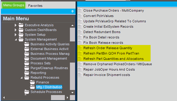

I’ve seen issues where the Part tran gets out of synch, and a cleanup process is needed.
It must happen so often, the Epicor made it a regular on menu process. Actually 3 different processes that might apply to you. (Granted this is E10)
Thanks Calvin, i think in E9 its the conversion that does these.

The conversion im currently running is 6690 “refresh orderrel quantity fields”

6690 seems to have fixed the issue.
