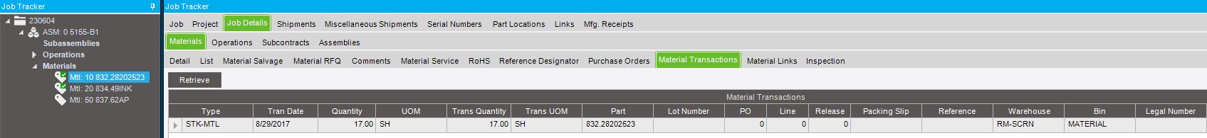

For the material with the check mark in job tracker, what does the material transactions tab say?
Also do you have the JobAsm table in there? I don’t think you can tie the material to the operation without going through the JobAsm table.
Material Transactions say 17.00. JobMtl.IssuedQty says 0.00. Maybe I am a little confused on what the IssuedQty is referring to. I am guessing in the Part Trans that it shows the most recent input; whether it be an adjustment or issued material, correct?

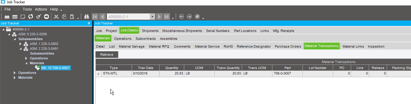

can you show me this tab? in a screen shot? That’s from job tracker.

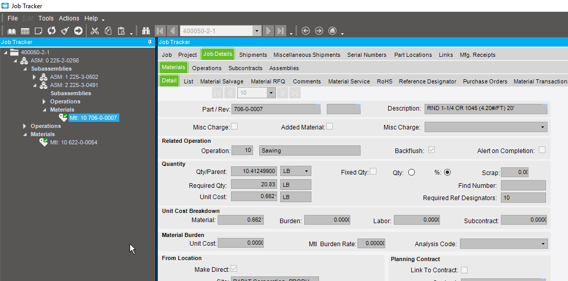

The other this I would like to see is your material detail tab. I want to make sure you have your job set up correctly.
ok, that looks right. Can you show me the grid of the BAQ that shows you that that material is not issued? Just that line with headers is fine.

I see what’s wrong, you are grouping by job head part number, and looking for material part numbers that have 0 issued. The third material on you job isn’t checked, that’s returning your 0 line and making that job show up in the report.
Ungroup the stuff and remove your filters and you will see it. (just filter by this job number.)
