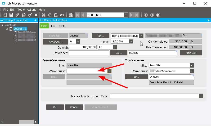

Has anyone ever seen this before and know what causes it? Presumably, it’s because the resource/group on job didnt have a wh\bin set.
Warehouse list is blank and bin is greyed out. I can manually enter a wh and then a bin and it works. If I report quantity on a job and a WIP location is not set on the resource, where does it go? I cant find it in part locations, but I can apparently pull it from thin air.

There is a primary warehouse set for the part, but not a primary bin.
Also, I have not discussed it yet, but I also have an issue where the mtl costing shows up as 0. I guess we’ll cross that bridge once we get past this one. This job has many coparts and all of the parts use Lot Avg Costing :nauseated_face:

In 10.2.200, we noticed this too. I believe it is working as designed when we contacted Epicor earlier this year. It is a change in behavior since 10.2.100.

So I guess my biggest piece of confusion is when I report qty on a job - why cant I locate it anywhere in WIP?

Thanks for info. The quote above leads me back to my confusion. If I am receiving from Job to Inv, why would I even need a from WH\Bin? :exploding_head:
If you are using the AMM module you need this bin…otherwise you do not need it.

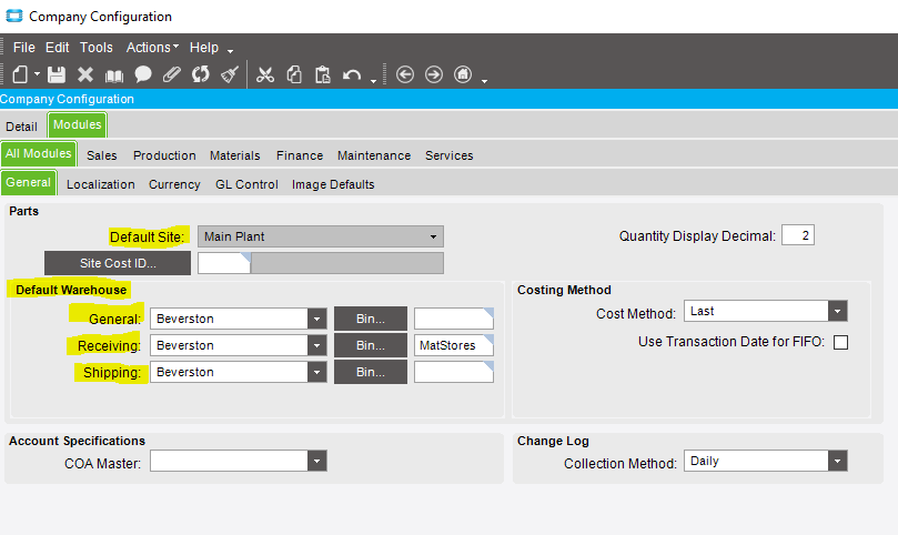

have you set a default warehouse for your main site?
if you want to do that for a specific site then you can set it here:
