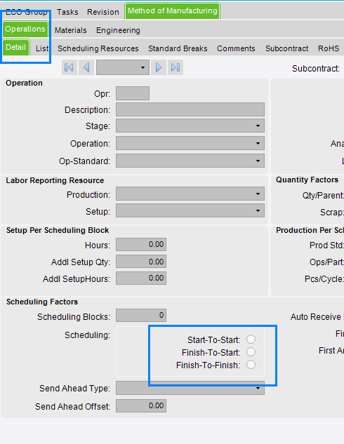

It sounds like a Send Ahead type of Start-to-Start with a Send Ahead Offset of 1 Piece would help align the operations more closely to what the line is actually doing. @Craig’s screenshot shows where this is set in the method on each operation.
I agree, except shouldn’t that be doing the same thing since we run 1 job, 1 piece anyway. Every part going through the line gets its own job number, so the job would be finish to start from the next job and the send ahead would have nothing to send ahead. it works great if we keep all our our operation cycle times consistant across all products, but as soon as we change the cycle time, it messes it up.
