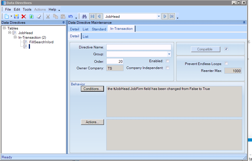

If you haven’t done so already, you can at least add your conditions that identify whether the job was firmed or released. I made the firmed one so you can copy and do the same for the released field (see image below). These identify whether someone has attempted to firm or release the job, so that you’re stop exception only runs when someone does this.

Yea that makes sense. JobMtl.RequiredQty = JobMtl.QtyPer * JobHead.ProdQty, so you won’t need to worry about the prod qty, just the required qty. As long as each part is only stored in 1 warehouse, you can compare this qty to PartWhse.OnHandQty with a criteria on PartWhse or JobMtl in your query condition. If JobMtl.RequiredQty > PartWhse.OnHandQty, then return the record in the query. If 1 or more records is returned in the query then the query action passes, so stop exception can run.
