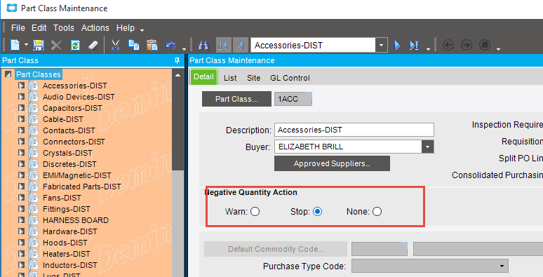

Not sure about your BOM, but cant you use part class. BF still will create a neg though
So is your DD on PartBin then?
Part classes are set to stop. However, our BOMs are set to BF.
