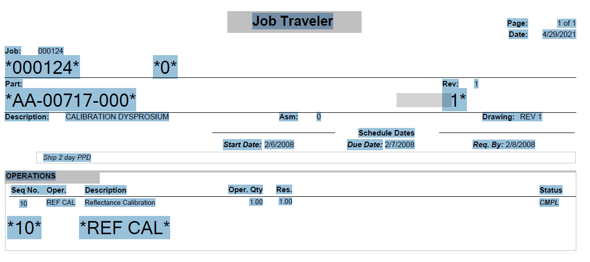

Nevermind, I see it now sorry. Are running the report normally to test, or testing in the report builder?
I was just trying in RB, tested in Epicor and this is what I get. The gray box to the right of the PartNum is where I was expecting the output.
Changing the parent and child relation of jobhead and part did the trick. Such a simple oversight on my part. Thanks Adam for the suggestions and 2nd set of eyes on this.
