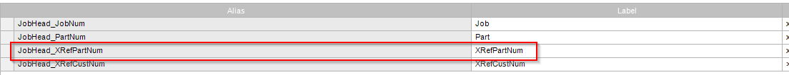

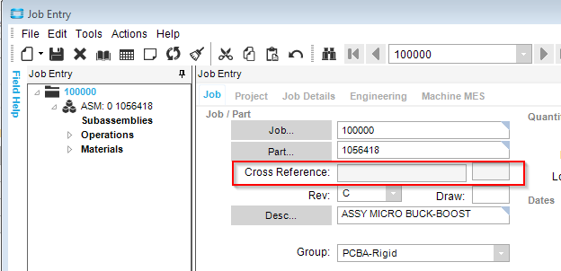

So the JobHead table have a field called “XRefPartNum”. I assumed that if there’s an Internal Part Cross reference, it would pull into this field. However, it does not. Anyone have any ideas how this field gets populated? I see it in Job Entry, but not sure how it get populated.
It does pick up the Customer Part Cross Reference (CustXPrt.XPartNum). Per Epicor, it should also pick up Internal Cross Reference but we don’t use that at our company so I can’t confirm without throwing some test scenarios together.
Thanks Megan. I opened a case with Epicor. I think it would populate the XRefPartNum if it exists, but doesn’t seem like it. It’s all grey out, so not sure if there’s anything special that needs to be done to pull the internal part cross reference into JobHead.

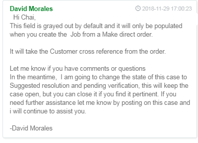

I did got a response from Epicor. See below.
