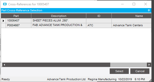

In the image below part 10005407 references another part in the cross-reference dialog that pops up when entering this part into different part number fields. Tables PartXRefVend, PartXRefMfg, and PartXRefInt are all empty for this part. Where is this being entered and how can it be removed?
Found it - CustXPrt. A couple people started using the Customer Part field in the sales order to reference a part that has the exact sequence as our existing part master.
