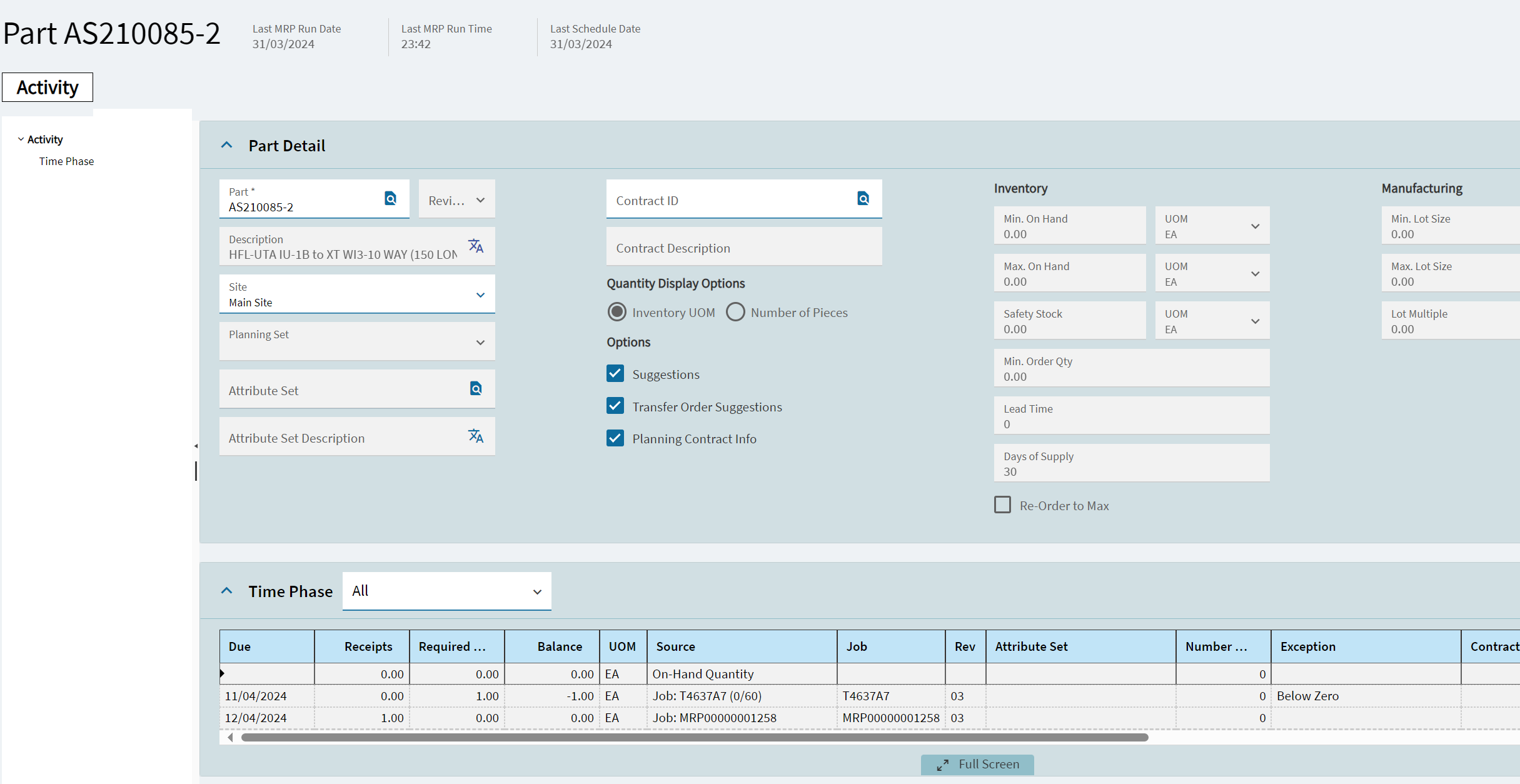

We are having an issue where jobs are missing in Time Phase. This is an example part, showing a job requiring Qty 1 and an MRP suggestion to make Qty 1.
However, the following job exists, is firm and has been scheduled. The job is ‘Make to Stock.’ For some reason it does not show in Time Phase. How can I get this job to appear? Thank you for any help :pray:

Not related to MRP but i’ve had jobs remove from TimePhase before as well. For me it was when i DMT’d a change to the job, for some reason it removed it from TimePhase, i have to always run a 2nd DMT to uncheck Engineered/Released then a 3rd DMT to check them off again this makes the job appear back in TimePhase.
@DKehler Woah, this is exactly what fixed it. I unticked Engineered and Released. Re-ticked both boxes and the job appeared in Time Phase immediately.
