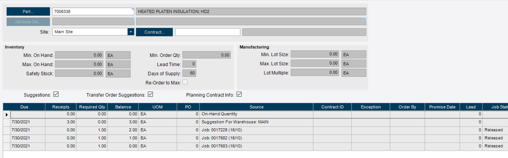

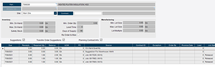

I have a part that was initially set up as a purchased part and recently we decided to make it in house. I changed the type in the part master to Manufactured in part maintenance and ran MRP on it. I did this with a couple other parts as well and all of them worked fine with this one being the exception. When I time phase the part it shows a suggestion like its still a purchased part which it shouldn’t and there isn’t an actual purchase suggestion when I go to the PO suggestions entry. And there is no job suggestion like there should be like the other parts I just changed have now. I looked all over part maintenance and cant find any difference in how this one is set up compared to the ones that worked. I’ll manually make the job for this part but my concern is if there’s other parts doing this I wont know it because id only see it in time phase

I thought the same thing but i checked and the part is set to manufactured at the site level as well. My tim phase is still showing a suggestion as if its a buy part but that suggestion doesn’t actually exist. It’s acting like I made a change and haven’t run MRP yet which I have
