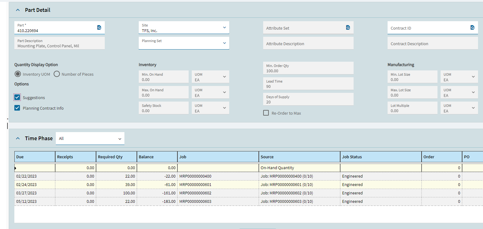

I have a part that we should be seeing a Suggested PO for but we’re not. We currently have Zero inventory and demand for a total of 183 pcs. First demand is on 2/22/23 and lead time on the part itself is 90 days. The part is set up as a Purchased part, Quantity Bearing, Generate PO Suggestions is checked as is Process MRP. I’ve also checked and made sure that the sales orders driving the demand are firm. I’m stumped!
Can you show a screen shot of time phase?
So many times it’s a date missing, which is usually apparent in time phase, but it could be something else too.
Here’s the screenshot of TimePhase.
ok, well that looks good. Can you show a screen shot of when you run purchase suggestions?

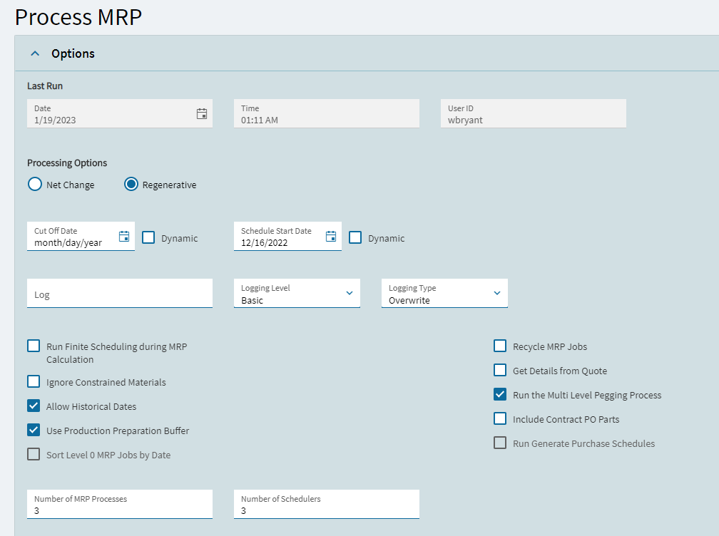

The MRP process is set up with a Scheduled Start Date of 12/16/2022 and we don’t have a cutoff date selected.

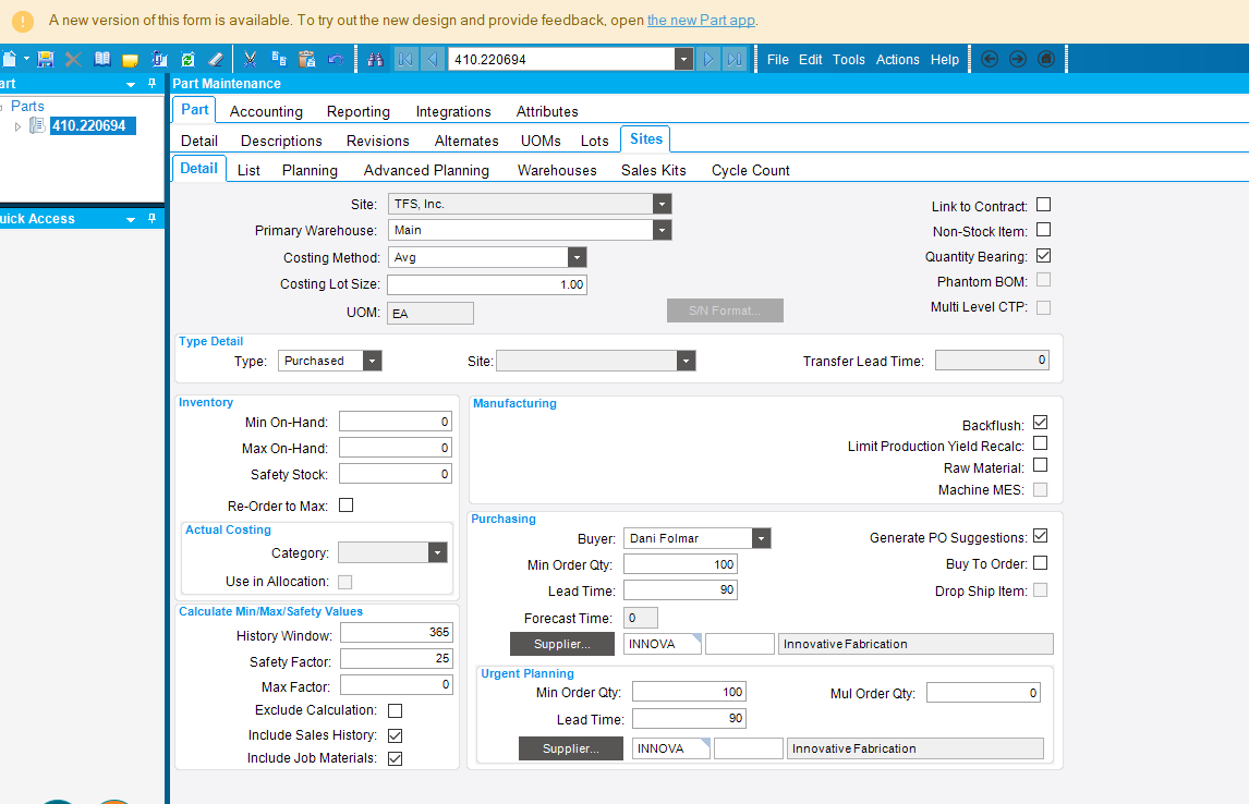

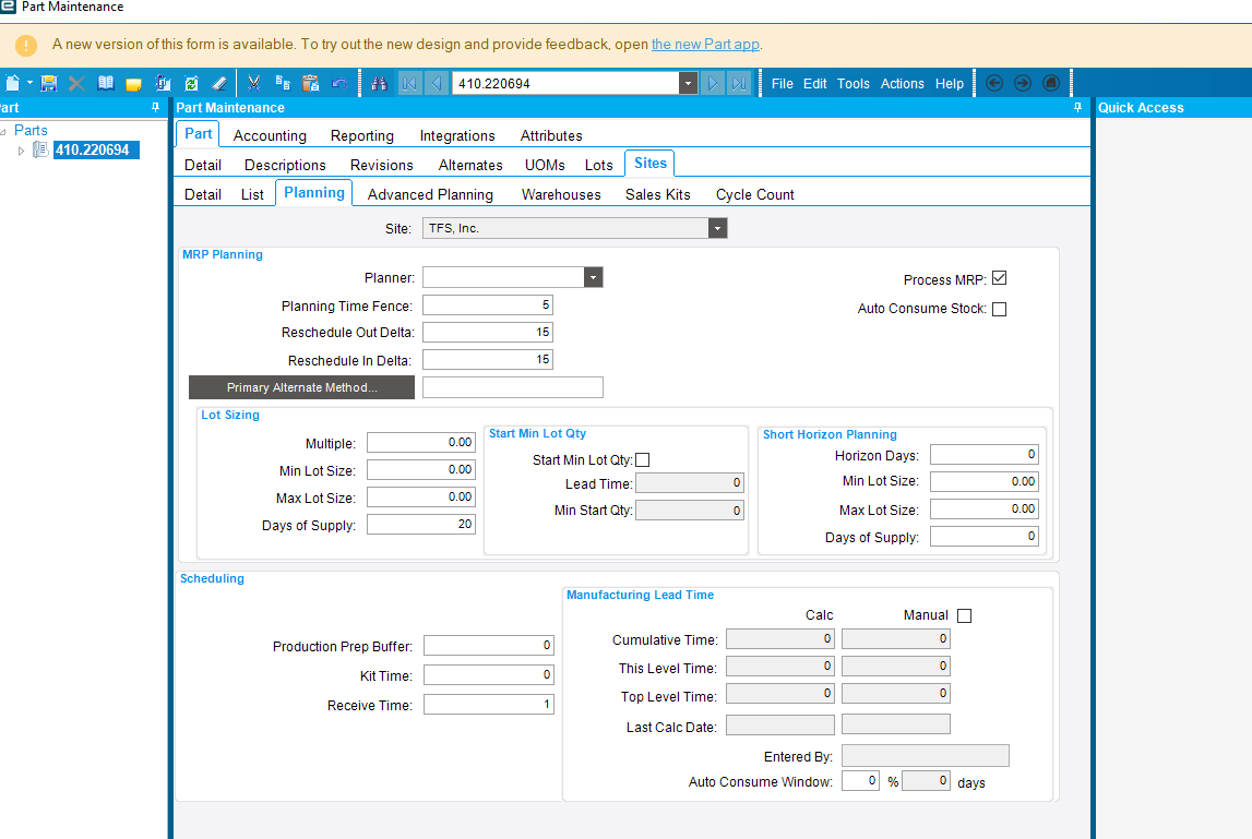

Can you also post a screenshot of the Part | Site screen?
I’m sorry, the Planning tab too please.
And, if you have Advance Planning and Scheduling, that tab too.
We don’t have Advanced Planning but here is the Planning tab…

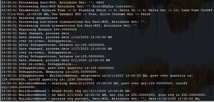

@WendyB I would run generate suggestion with a log file and logging level of suggestions for this issue and I would have the nightly MRP log at MRP and Scheduling so you can always review for oddities.
You get the details by part of the processing.
Running Generate Suggestions seemed to do the trick - the part showed up on the Buyer Workbench after that. MRP ran as usual overnight and the buy suggestion was gone this morning. Running Generate Suggestions again.

It could be that because Days of Supply is only 20. I included a snapshot of DOS definition.
I don’t think days of supply is it. The days of supply will look ahead from the next requirement, and if there any more requirements, will add those the PO.

Here’s a screenshot of the MRP settings.
Is there a reason you are using a start date of 12/16/2022?
