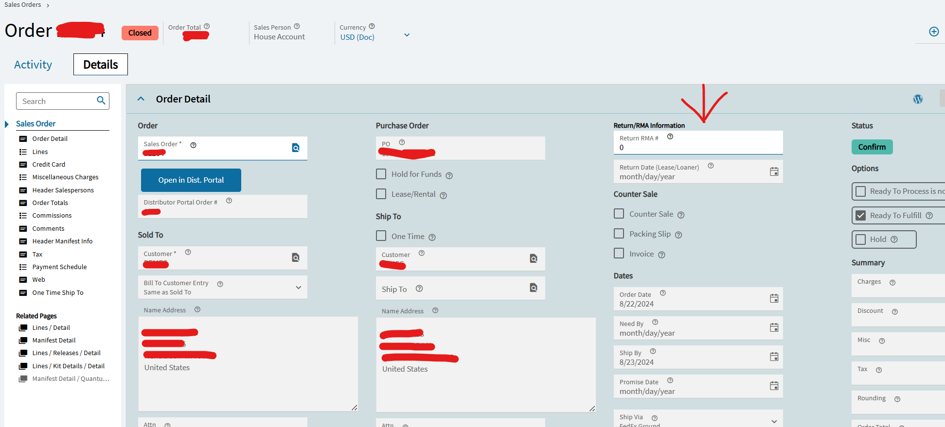

Is there a way in Application Studio to set a field to stay open after the form itself has been closed?
Specifically, I have a OrderDtl UD field (string) that I’ve placed near the top of the main Order Detail Order Entry form that remains editable after the order is closed (not sure why though). I’ve got another OrderHed UD field (date) that I would like to remain editable as well. Any idea how I could go about achieving this?

The business problem is that we have a rental and, separately, a loaner program where the rental and loaner terms (the expected return date) is quite often being extended. We’ve found ourselves using the Sales Order as the main landing page for tracking these, especially useful for rentals with multiple invoices (a recurring invoice). Everything connects from there. It’s a minor inconvenience to re-open the order and then close it.
I’m sure there’s a better way, it’s just that OrderDtl.RMANum_c remaining open (which is also at times useful when creating the RMA after invoicing) got me thinking it might be worth attempting. There isn’t any BPMs doing what Zack described; could it be accomplished entirely in an application studio event maybe? It’s more my curiosity now why it’s open. The return date isn’t even business critical; our main invoice or recurring invoice does that; more to loosely keep everyone informed.

Good question Kevin, I had to double check, but yes, it is. It does save and update when when a closed order is saved. I’ll hunt around some more for the logic controlling this and update if/when I find it.

Epicor runs this Row Rule on OrderHed
  "id": "openOrderRule",
  "condition": "OpenOrder = false or FSMSendTo = true or [TransView].[SysReadOnly] = true",
  "dataView": "OrderHed",
  "actions": [
      "action": "DisableRow",
      "exceptTheseColumns": [
        "OrderNum",
        "CustomerPrintAckShape",
        "ShowApplyOrderDiscountsControlShape",
        "OpenOrderShape",
        "ClosedOrderShape",
        "InactiveCustomerShape",
        "InactiveShipViaShape",
        "LinkedShape",
        "LinkedIssueShape",
        "LOCHoldShape",
        "CustOnCreditHoldShape",
        "CreditOverrideShape",
        "HoldSetByDemandShape",
        "ERSOverrideShape",
        "ExtAOEShape",
        "OTSSavedShape",
        "ShowKitDetails",
        "CounterSaleProcessedShape",
        "MakeDirectReleasesNoJobLinkShape",
        "ReadyToProcessNotCheckedShape",
        "AttributesRequiredShape",
        "ViewTaxToolTracker",
        "InactiveShipToShape"
  "customizable": false,
  "disabled": false
You may need to add a Row Rule but the problem is that there isnt a SettingStyle.Default Maybe if you set a condition where OrderNum = 0 then SettingStyle.Disabled perhaps it will reverse it. Or you use DisableRow and list all the columns that Epicor disabled + yours in the except, or add yours.
Other things you can try is setting Extended Property, or see if you can mark the Column a Key Field.
