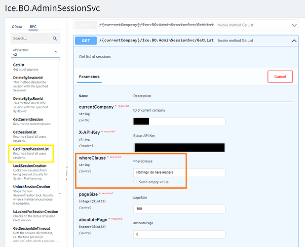

If not, it’s fine. I’m just asking.
It looks like I can use GetFilteredSessionList which is bizarre but what I need. (The filter of 2 = inactive users.)
But for the sake of argument, what is the syntax for the whereClause here?
I’m used to it being SQL syntax (wrapped in double quotes). So I expected to do
"InUse = 0"
But that did not work, nor anything else I tried. Nothing caused it to fail , but nothing filtered the results either.

Firstly, GetFilteredSessionList is a POST rather than GET
As for the GetList. You wanted to filter out InUse
I did it using
Are you getting any errors?

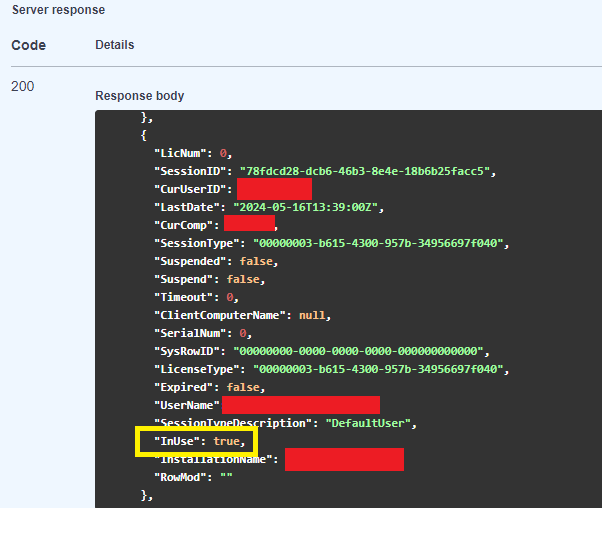

I tried this just now, but I still get trues:
Yours looks different than mine. Might just be the version.

9
Sorry still get the same. Are you getting only falses as intended?
I’m using the Swagger page. It says Request URL is this (I redacted sensitive parts):
https://SERVER/INSTANCE/api/v2/odata/COMPANY/Ice.BO.AdminSessionSvc/GetList?whereClause=InUse%3Dfalse&pageSize=0&absolutePage=0

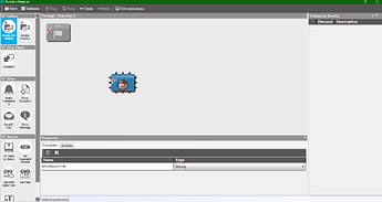

OK, new question.
I am switching to GetFilteredSessionList and as was pointed out, it is a POST needing a JSON input.
So, that’s new territory for me.
I tried what I found on the Internet , which ended up as this:
JsonSerializer.Deserialize<ActiveSessionFilter>("{ \"filter\":2 }")
Checked Syntax and got the OK. Great!
Until I tried to save the EFx, and then I got this:
KillInactiveSessions.cs(81,21): warning CS0618: ‘JsonSerializer’ is obsolete: ‘Use the Newtonsoft serializer.’
KillInactiveSessions.cs(81,21): warning CS0618: ‘JsonSerializer.Deserialize(string)’ is obsolete: ‘Use the Newtonsoft serializer.’
OK… So I searched what others did here (@klincecum ) and saw that Epicor people use:
JsonConvert.DeserializeObject<ActiveSessionFilter>("{ \"filter\":2 }")
And that saves OK, but all I end up with in Postman is “Sorry! Something went wrong.”
I’ve never tried to deserialize to JSON before.
Life is hard.

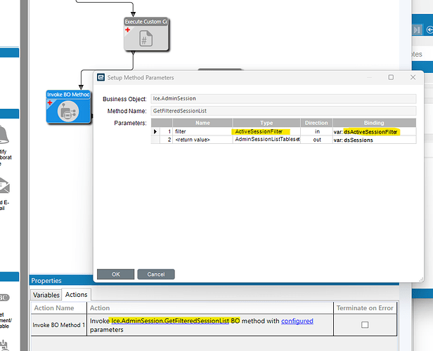

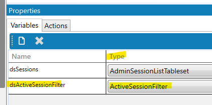

I’m using the Invoke BO Method widget and the input parameter is a variable (or expression, I suppose) of type <ActiveSessionFilter>
So, I am trying to turn
{ "filter" : 1 }
into the variable for filter - but not that filter; the filter in my first pic of this reply.
Simple, right?

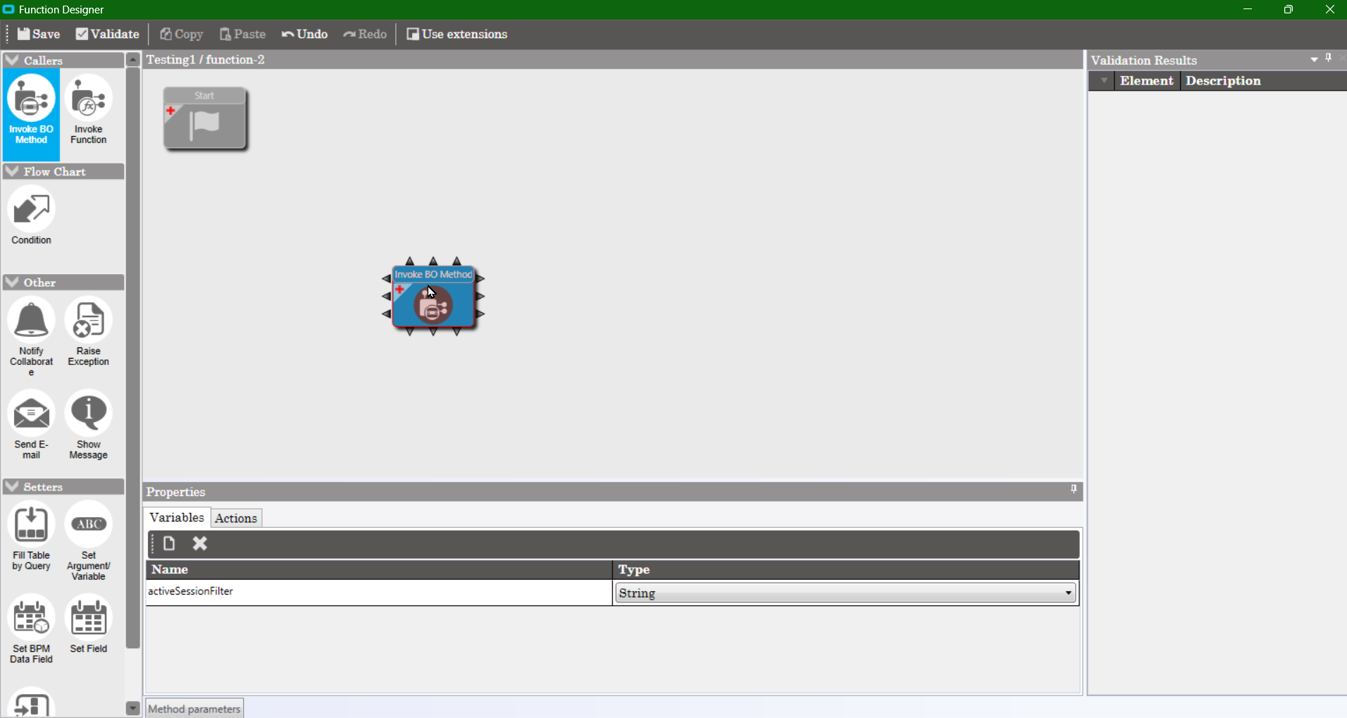

Well, on my version 10.2.600.26 that is simply a string. My thought would be just set it to a “2” not sure what your ActiveSessionFilter type is but you will need that to properly setup the object to pass to the BO Method.
I asked it to create the variable and it created a simple string. So for yours I dunno, but I would try it as just 1 or 2 as the assignment for that. I would need to know the structure of that TYPE ActiveSessionFilter to point you further
