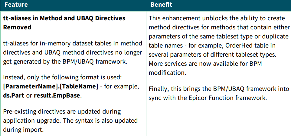

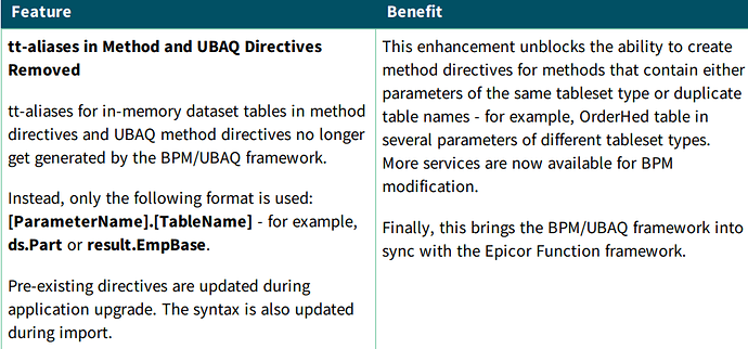

From the Kinetic What’s New 2021.1 PreRelease pdf on page 17:

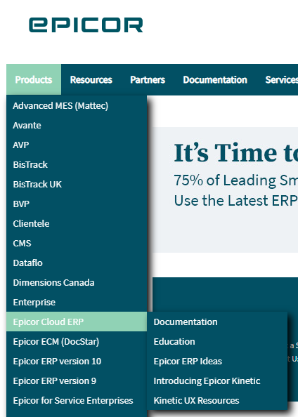

Edit: Found the link - Log in to EpiCare, then go to Products > Epicor Cloud ERP > Documentation:

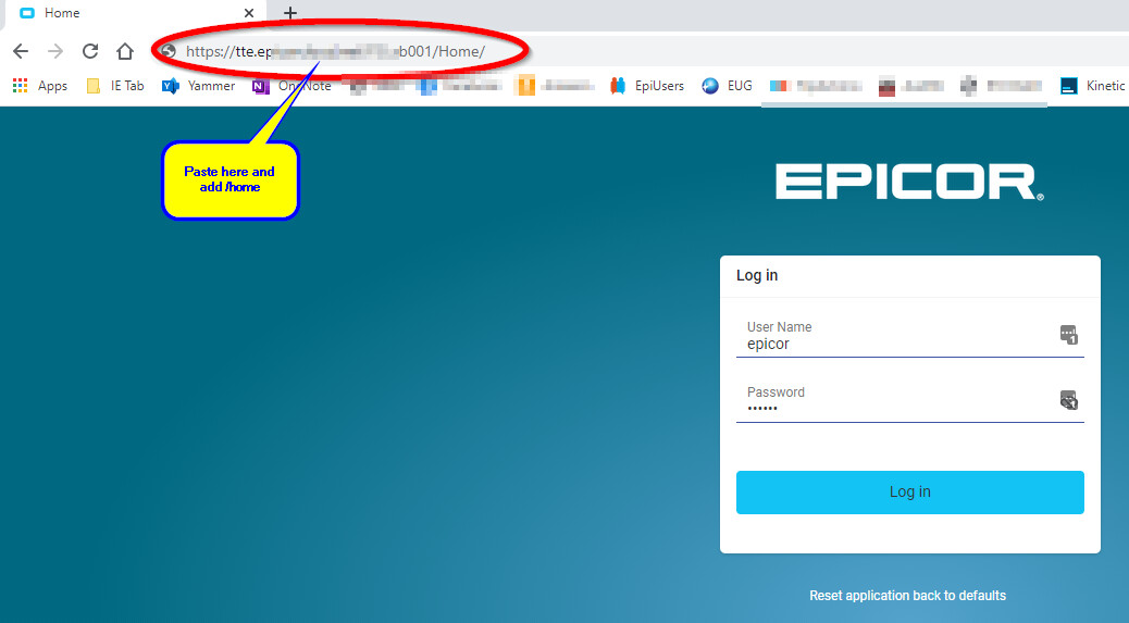

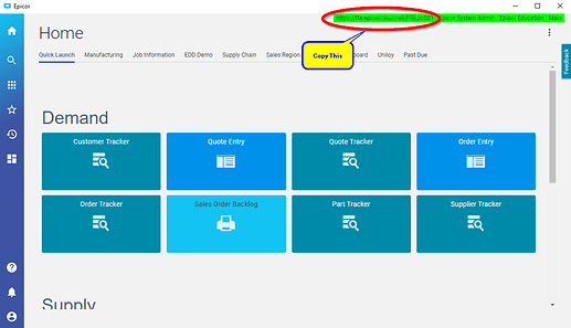

Running from CLIENT vs from BROWSER… some people don’t know how… here is how:
- when you run from CLIENT, you will see a web address at the top of your kinetic menu such as:
https://my.epicorsite.net/abc001
- COPY this value and paste in into your web browser but add /home to the end. This takes you to the web native version.
https://my.epicorsite.net/abc001/home
Note that the first time you launch a program, it may take a little longer to cache things, but the second time will be very fast.
Also, in the Pilot and test accounts, you may not be able to run the old client programs from a browser because you may not have purchased the EWA license for Pilot (I think that is what you need).
Below are some screenshots for illustration:

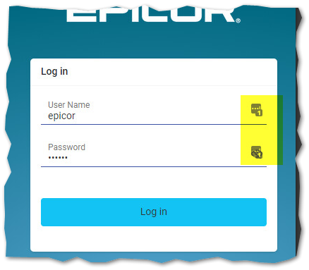

And as a bonus, it looks like your password manager (LastPass I’d guess), will remember your login info for you.
And as a bigger bonus, if you use Azure Active Directory, you don’t have to remember another username and password. Or a password at all if configured. Also, since Epicor would be a registered application, and if you use Microsoft’s Endpoint security, you get all the features (MFA, impossible travel, passwordless, …) that you can’t get with username/password.
Your message of the day. I’ve been slacking. (Or Teaming? )
Yup… lastpass remembers the login and password.
