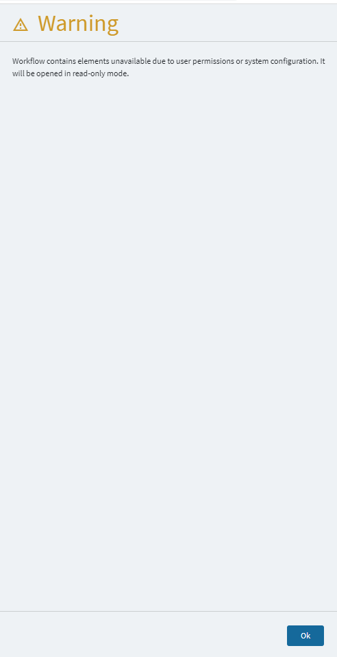

So we are testing 2023.2 in a test environment and one of our Bartender BPMs was not working while testing…And I get this message (Yes I am added to the security groups for both method and data directives as well as I am in the owning company of the BPM)

I saw this too, then I opened the same directive in classic and it was fine. I haven’t had the time to report it but seems like a kinetic issue?
Yep I just figured this one out a few minutes ago…I tried to only do data directive as classic but would throw an error so I had to do the entire BPM folder to launch from classic.

Read only can be directives that contain some elements that are not yet implemented in browser.

I tried both in the client as well as the browser and if it was launched with the Kinetic UI with no luck of being able to edit the BPM
It probably contains something that is not implemented in the version you use. Create new directive in browser and you will see what is avaialble in the moment
It contains the condition I have posted originally which I think is an issue…Updating/Adding/Deleting a row from a table as a trigger is a staple to many BPMs so I am unsure why Epicor would not have this implemented in the latest version 2023.2 for Kinetic!
Moving BPM designer is huge amount of work, so it is done gradually.
In 2024.1 I think we will have all supported actions/conditions.

So just now upgrading to 2023.2… is there no work around other than just use Classic for BPMs?
Currently on 2024.1 in our test environment soon to go live with it in our production environment and can confirm you still have to use Classic for CREATION of the BPMs to not lose certain conditions. The BPMs will still fire in the kinetic views
