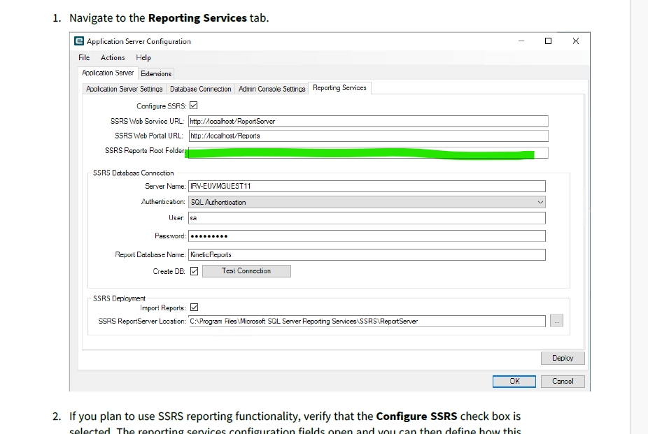

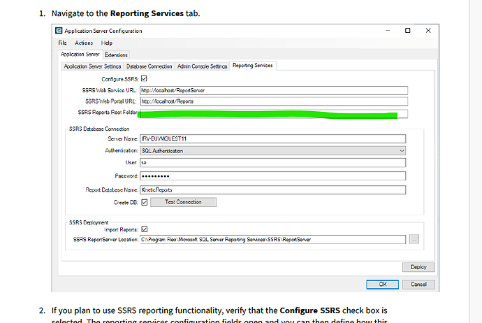

FYI others: The upgrade guide still says: “If you have SSRS Reporting Services installed, navigate to the Reporting Services sheet and
select the Import Reports check box.”

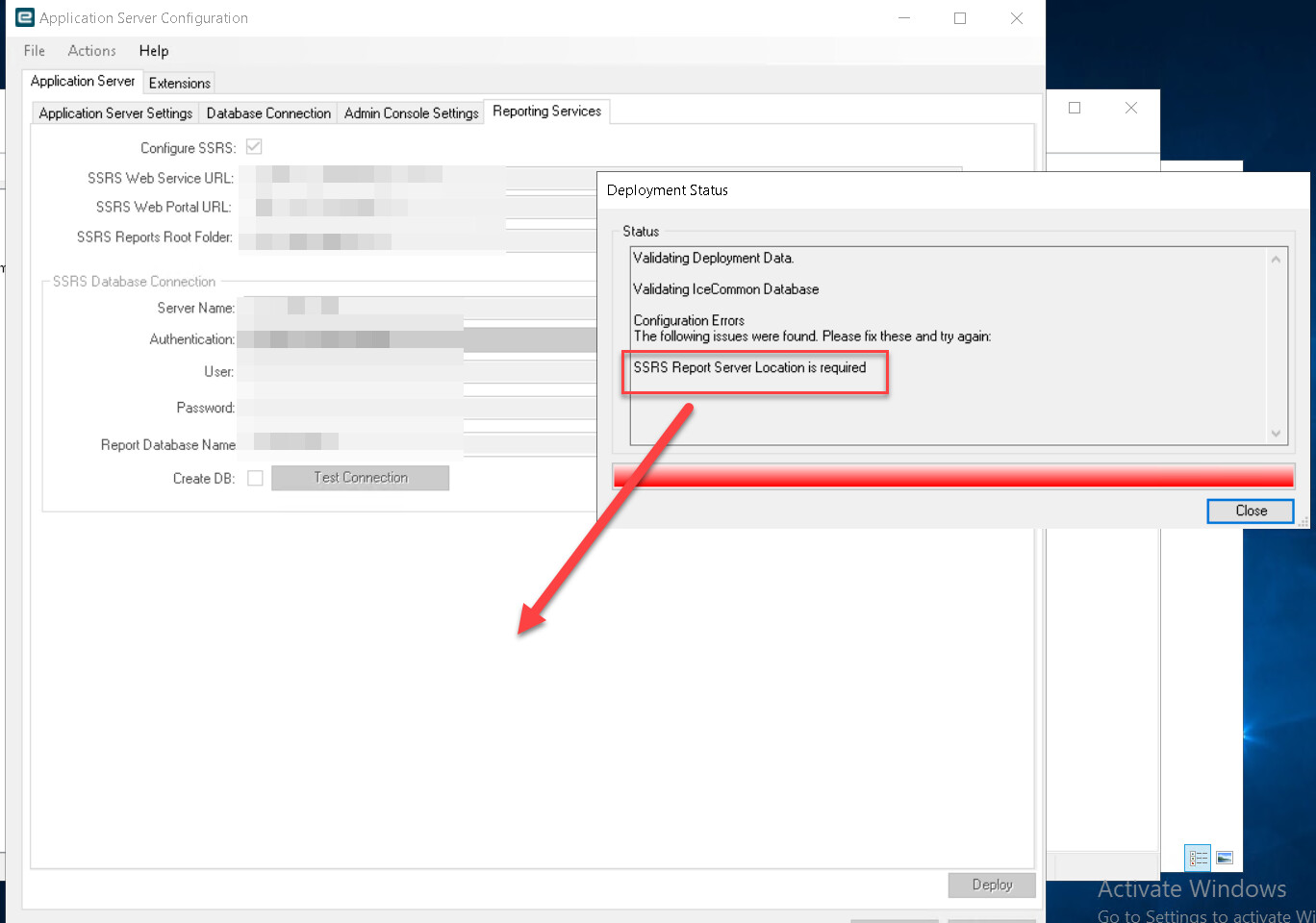

I just couldn’t even get the app server registered because it kept complaining about SSRS

I was hitting an issue during the registering of the app server where it was saying it didn’t have access to the report server path (which was filled in with a UNC path). The UNC path that was in there was something like this:
"If the SSRS server is on a separate machine, enter the UNC path to the
\\ReportServer directory. The current user account must have
permissions to write to this remote directory. For example, enter:
\\C$\Program Files\Microsoft SQL Server\MSRS10_
50.MSSQLSERVER\ReportingServices<RemoteName>\ReportServer.
