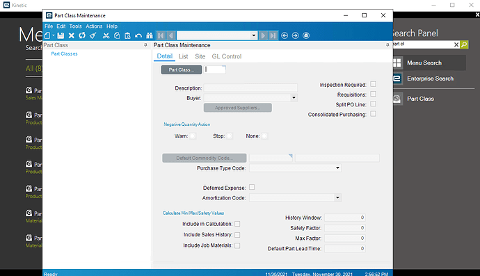

When I toggled to Off ‘Enable New UI’ on the Main Menu and Company notes, there are still menu items such as Part Class that are opening with Kinetic instead of Classic. Is this correct but seems buggy that you can’t disable all Kinetic forms or if this is the intended direction moving forward with some menu items opening only in Kinetic form. I believe Kinetic Application Maintenance overrides all settings unless I am missing something.

Is that how your Part Class looks like? can you show me your screenshot.
I am on 2021.2.6
It displays Kinetic form only. Did you disable both the Main Menu and Individual companies?
Yes I disabled both. everything. one folder item at a time. Then I restarted my Client and I was set.
When I expanded the Main Menu node, it doesn’t display all the modules such as Part Class, etc to disable it item by item. I only did it at the Main Menu level to disable the child nodes. Everything is disabled off but still not working.
