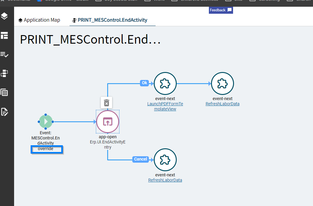

KB0132464 - Steps to Deploy a Kinetic Customization to a Kinetic 2023.2 Data Collection Button
It is different depending on which version of Kinetic. 2023.2 has the option to override the original mapping to the base form. This is on the MES main form after you do the layer on the underlying application.
Prior to the advent of Override you can just hook it to a Before event and then throw in an Exit at the end.

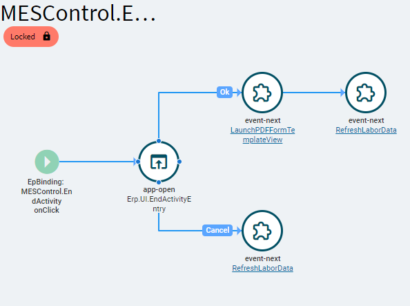

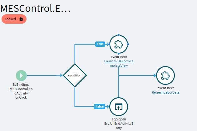

We just ran into an issue with the End Activity control while testing 2024.1. We are currently on 2023.2 and found that the base control we copied (and did the override on to call our layer) had changed in 2024.1 giving us an error. I had to re-create using the new Base control to get it working again.
2024.1
2023.2
I asked Support and not surprised that it has to be redone.
Here was my write up on this issue a few weeks ago, if it is helpful.
I ran into this same problem with our testing. By starting over at the new base MES form, that resolve the issue. It didn’t like the new event on the new base layer with the old custom layer on top of it.
By the way, there was one step missing in the KB article under certain circumstances. For the End Activity button, the app-open widget is opening Erp.UI.EndActivityEntry and putting the layer name in the parameters worked well.
I did this same thing with the “Return Assembly/Material Request” button. In this case, the event did an app open of DEGO1050 (the menu item). Along with following the steps in the KB article to use an override, I also had to go into Menu Maintenance and add the Kinetic Customization Layer to the menu entry.
