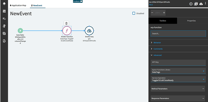

Now I’m trying to setup the Event Application Studio for when the Checkbox on the grid is clicked on that it calls the function and passes the SysRowID and new checkbox value…

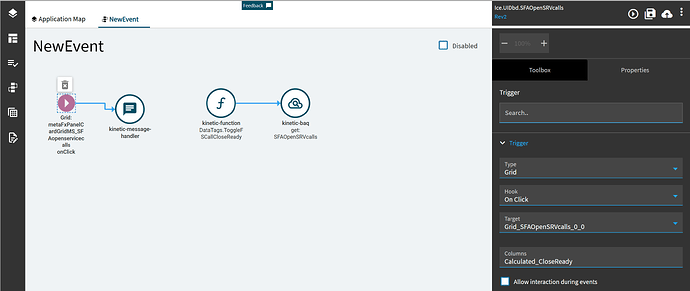

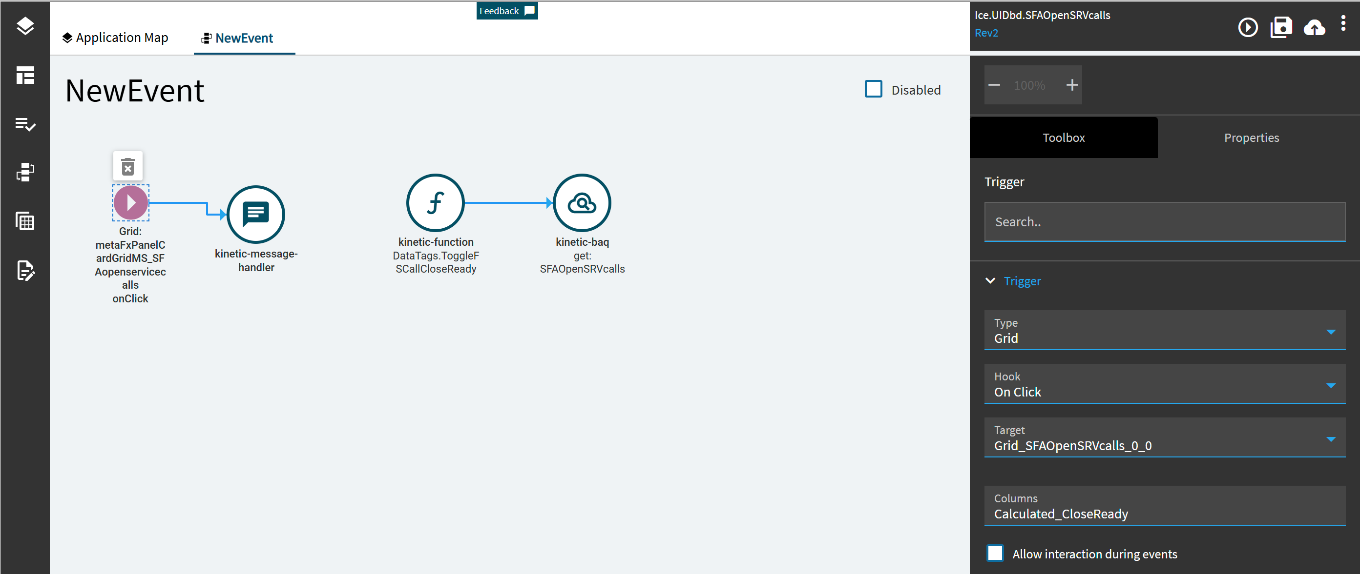

Put a screenshot of your event.
BTW - the parameters that are passed really don’t matter since the first action in the Function is to send me an email to confirm it’s getting called. I tested this with the Schedule Function and didn’t enter anything for the parameters and I rec’d an email.
But if I check the checkbox on the grid row nothing happens. (BTW - I’m enabling the checkbox on multiple rows as I don’t trust the timing of the vent)

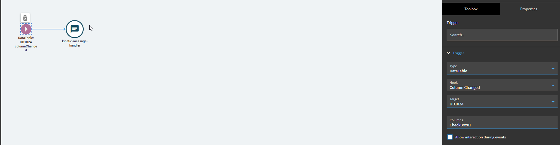

Are you sure you have the binding correct in your grid? I just added a column to my grid bound to a boolean field and the data table column changed event successfully fires.
No I am not… I am overwhelmed with the different event options and I have no idea which one to use.
I have tried so many just to get a message popup and nothing.
what event and parameters are you using? Could you share a screenshot?

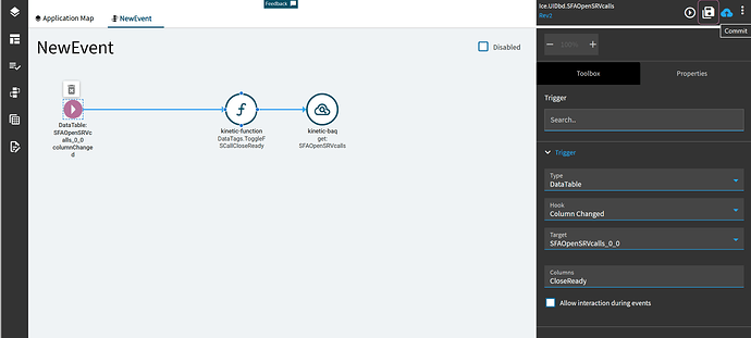

thanks… I compared everything and I don’t see what’s wrong:

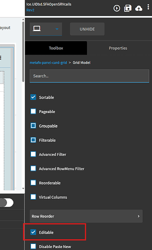

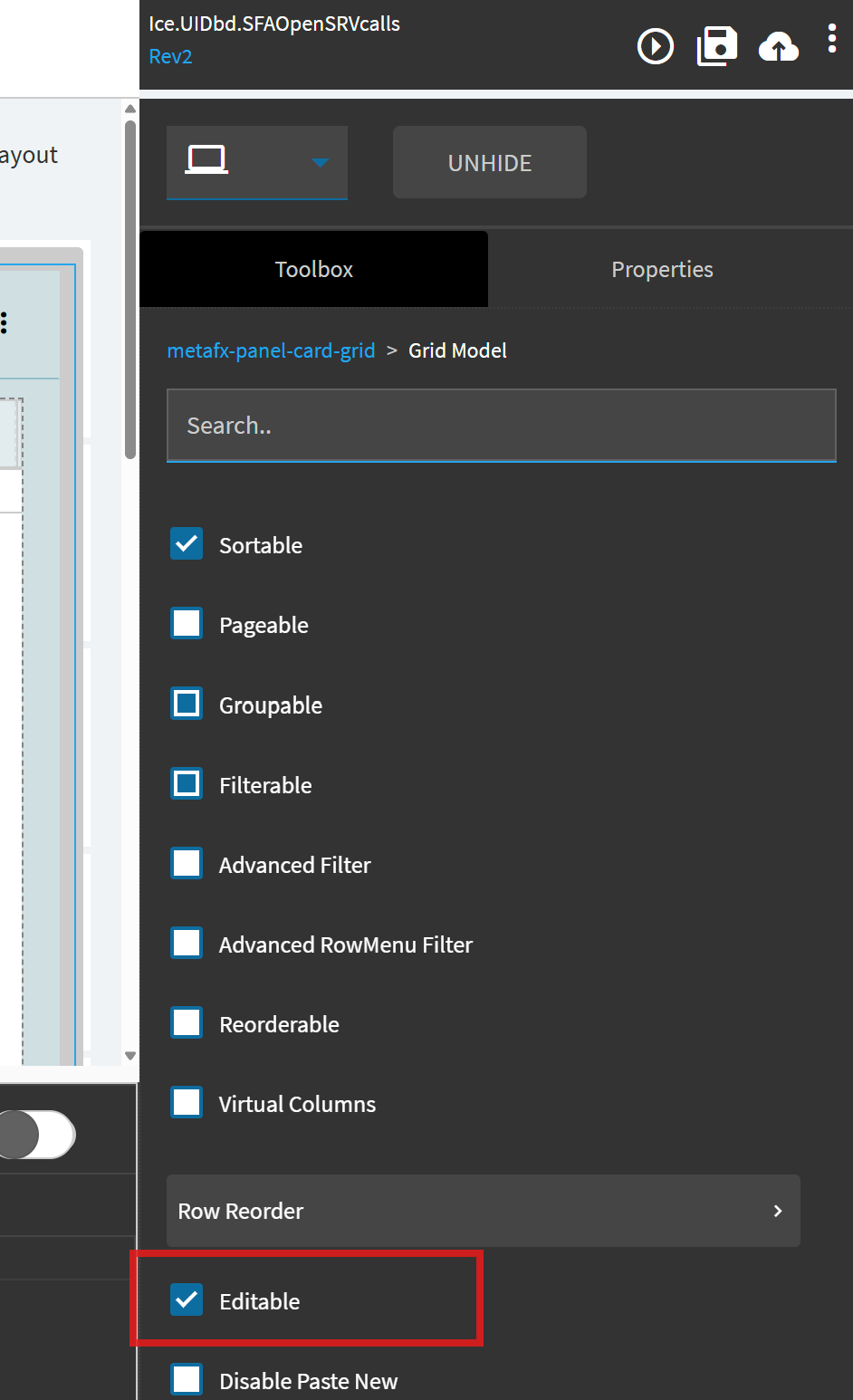

Is your grid editable?
Yes:

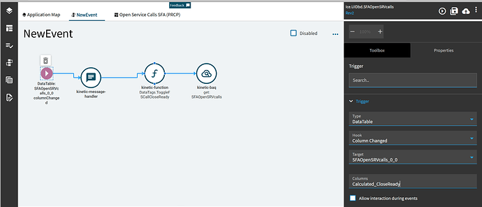

Column changed is the correct one.

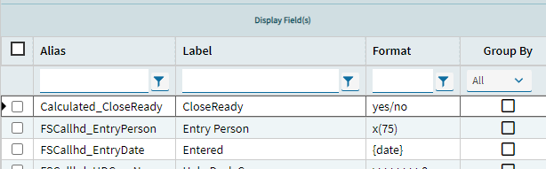

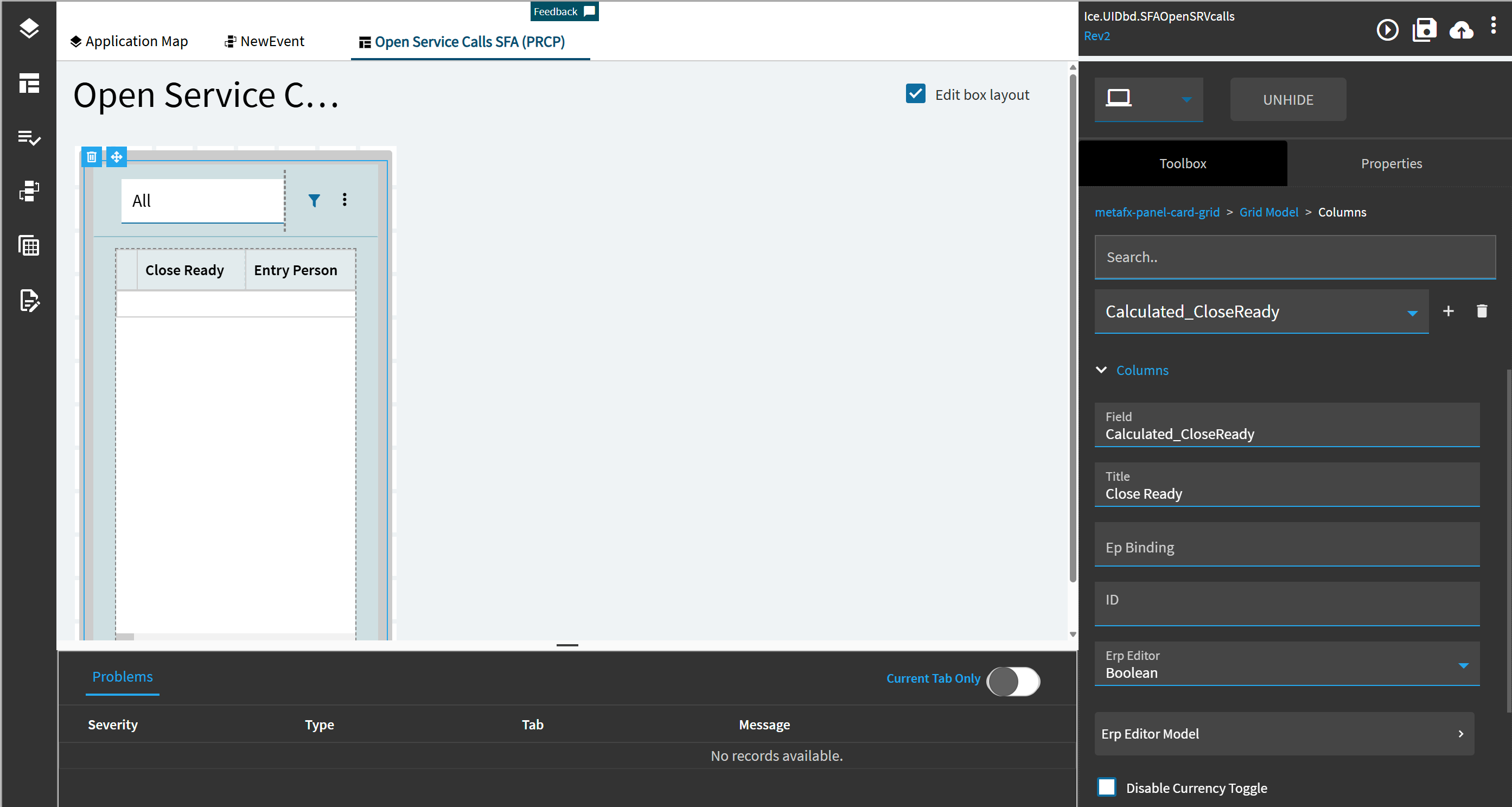

If the Field is driven from a BAQ then the field name will more likely be something like Calculated_CloseReady which would be why the event is not firing. Check the true field name / alias in the BAQ / network calls / Data View in App Studio.
Sorry, I’m on 2025.1
BAQ Field Name:
Network Calls?
Data View in App Studio:

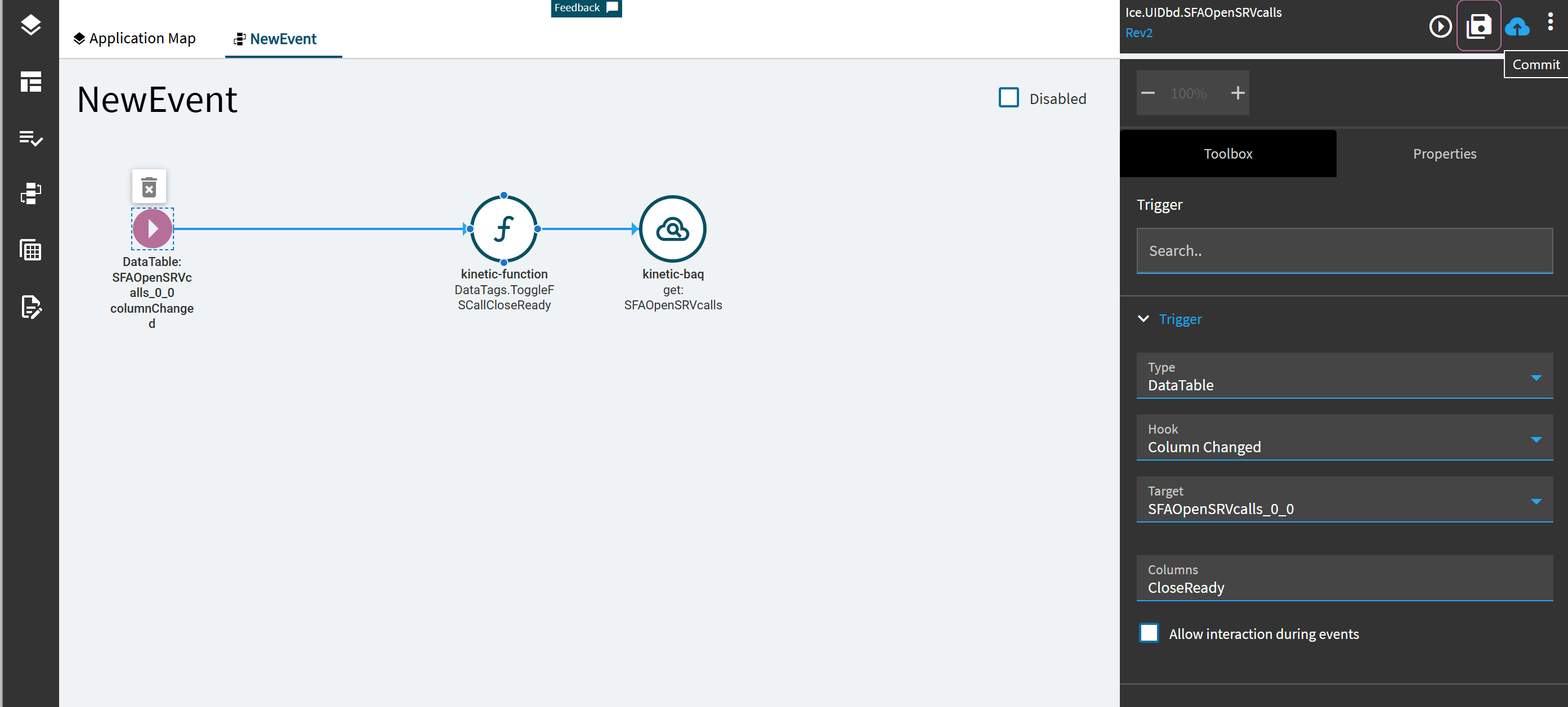

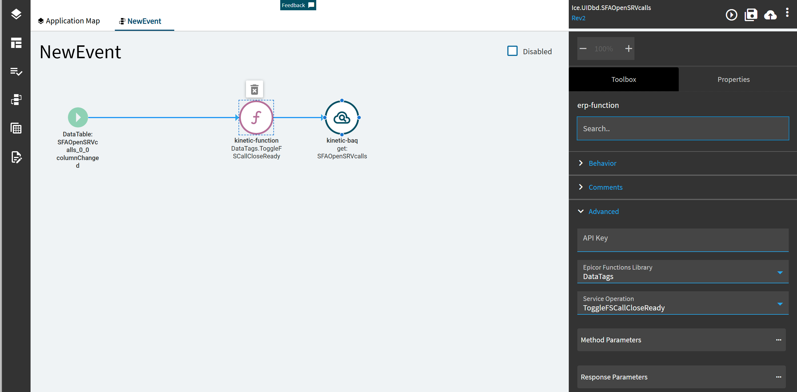

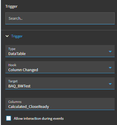

So from your original post i believe the main issue you had was the event not firing. Which is why i said the correct trigger is column changed and you need to use the full alias of the BAQ field.

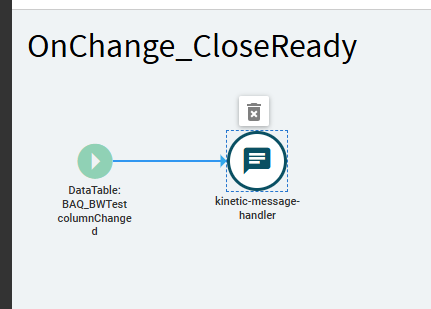

I have just tested on 2025.1 and it works as expected. My Dataview name is BAQ_BWTest so you will need to change as needed. And i have just put a message handler in as a test.

In the end here is the keys:

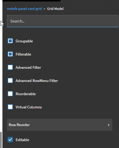

  • BAQ does NOT need to be Updatable

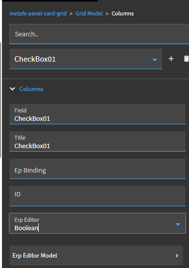

  • Grid needs to be ‘Editable’ (metafx-panel-card-grid > Grid Model)
  • BAQ Checkbox field needs to be ‘Editable’ (metafx-panel-card-grid > Grid Model > Columns)
    • Erp Editor does NOT need to be set
  • Event needs to be Type ‘DataTable’
    • Hook: Column Changed
    • Target: the BAQ Data Table\View thing
    • Columns: the name of the column alias (no brackets required)
