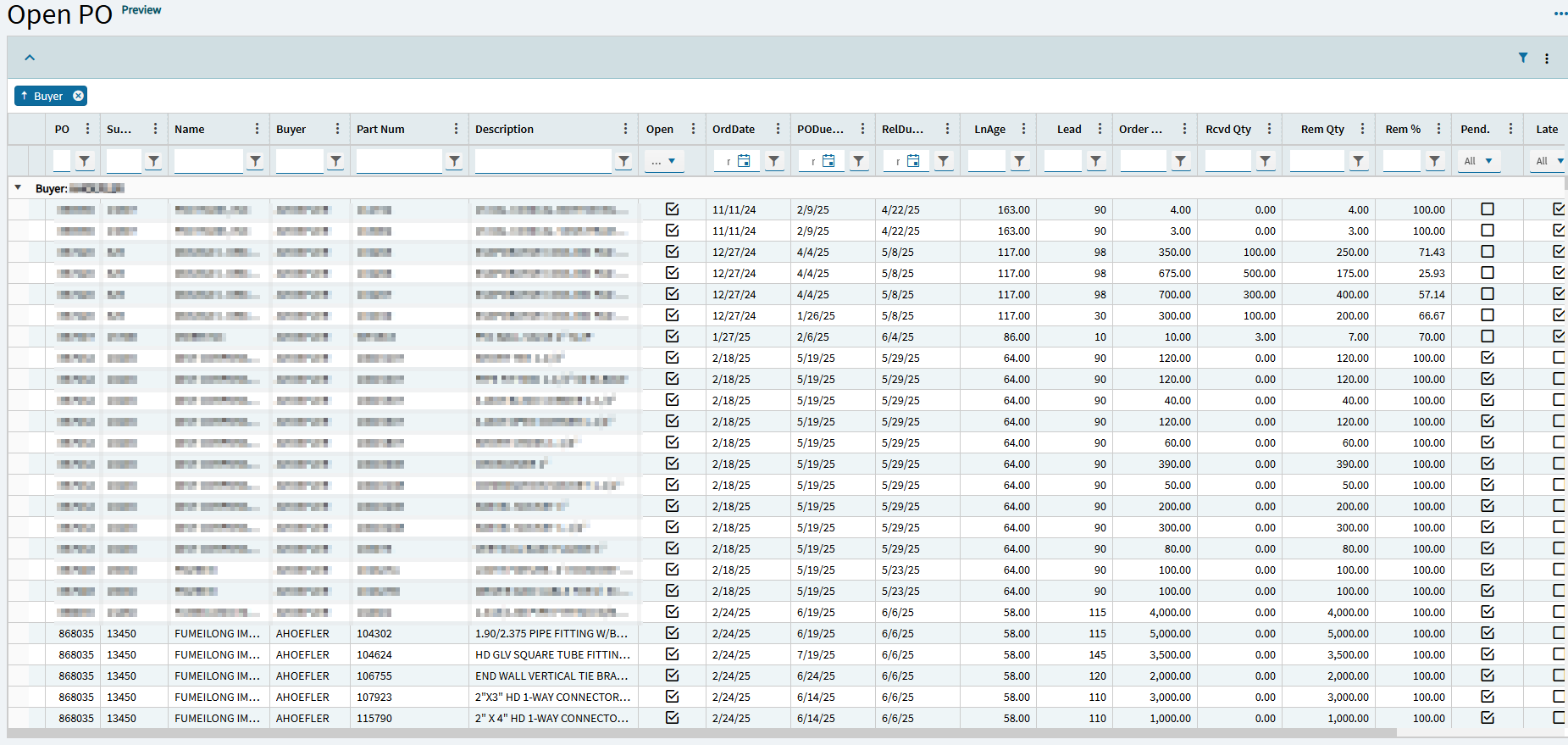

What can I do to speed up the Kinetic dashboard groupby filter expansion?
I’ve got an Open PO Dashboard for our buyers, which shows Open PO’s, with info from lines, releases, and the supplier and parts tables.
In classic, it loads ~900 rows nearly instantly. If I want to groupby the buyer field, I can right click, turn on groupby, drag the buyer field to the top of the grid, and it instantly groups all the data. I can click the + to expand the group, and nearly instantly, it shows that buyer’s PO’s.

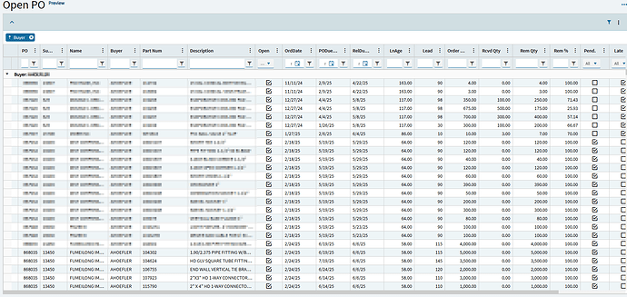

In Kinetic, it’s a dog! If I don’t set pagesize on the gridmodel, it takes a second to load (good enough). If I click the filter icon, and drag the buyer field up to groupby, that’s instant. Then when I click the triangle to expand that buyer’s PO’s, it takes 12 seconds.
Our buyers will not like that at all…
If I set pagesize to 2000, it takes 12 seconds to load initially, then another 12 when I expand the groupby (so nothing gained there…). We’re on-prem, if that matters.
What can I do to speed it back up to what we’re seeing in classic?
