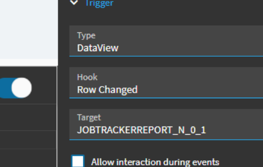

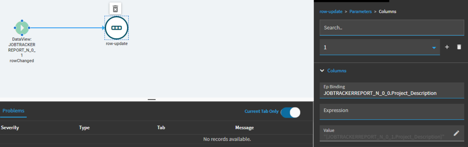

An event with a trigger of:
  • Dataview
  • Row Changed
  • Target: JOBTRACKERREPORT_N_0_1
event action > row-update

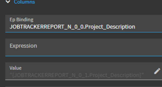

Column1:
Binding: JOBTRACKERREPORT_N_0_0.Project_Description
Value: "{JOBTRACKERREPORT_N_0_1.Project_Description}"
Column2…
Column3…
Column4…
etc.
This event would trigger/fire if the user selects a row in the results datagrid and it would take the value from the results and overwrite the tracker dataview columns.
Hi, I tried the solution, but it’s not working. After selecting a value in the grid, nothing changes in the tracker. The same issue still persists.
Show the entire event chain.
