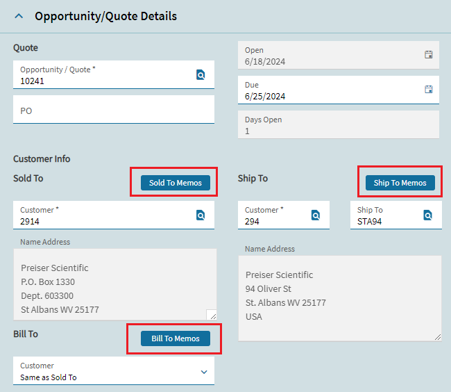

To be more specific, in Quote Entry. I made a Dataview that gathers every customer memo.
I have a button that launches a slider with a grid in it (pretty much what the memo slider looks like). And since the grid is linked to the dataview it shows every customer memo ever, and I want to filter that down to only show the memos assigned to the Ship To Customer that’s attached to the quote. QuoteHed.CustomerCustID
And I have a second button that would do the same thing, but for the Bill To Customer attached to the quote. QuoteHed.ShipToCustID

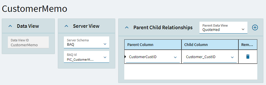

I can tether the dataview to just the QuoteHed.CustomerCustID in the dataview, however that only gives me the one customer’s Memo

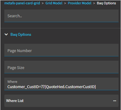

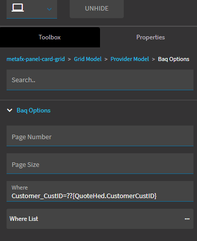

Hi Tyee… I’m a tad lost on where you’re breaking down. Is the below working?
If not try putting single quotes. CustID is a string, so I think needs single quotes:
Customer_CustID=‘??{QuoteHed.CustomerCustID}’

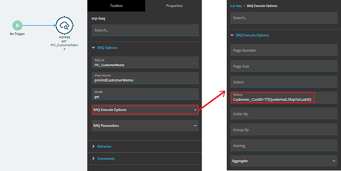

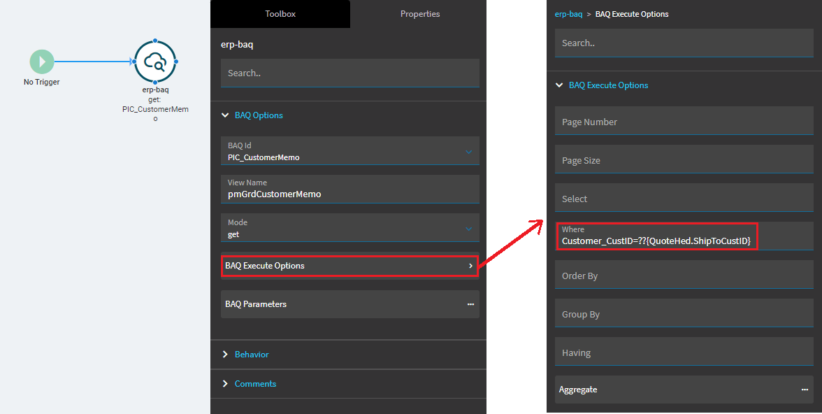

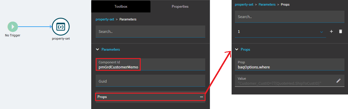

I did find this function though which does what I want, but I can’t get it to do it right after launching a Slide UI for some reason.

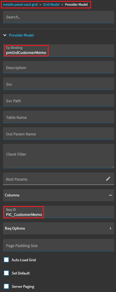

So if you define your provider model with a name in the ep binding.
You can update the provider model parameters with the erp-baq function.
But again, I can’t get this erp-baq tool to work after I launch a slide out UI. I don’t think the grid that I have in the slide-out has finished loading its data or something.
I am also guessing there’s a where property in the provider model object that I could change with property-set. But I have no idea how these objects are structured and how to reference/update those variables.
