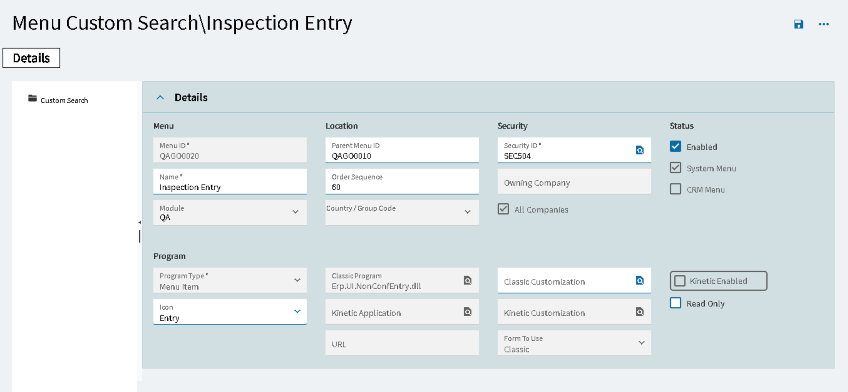

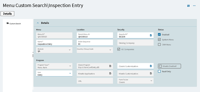

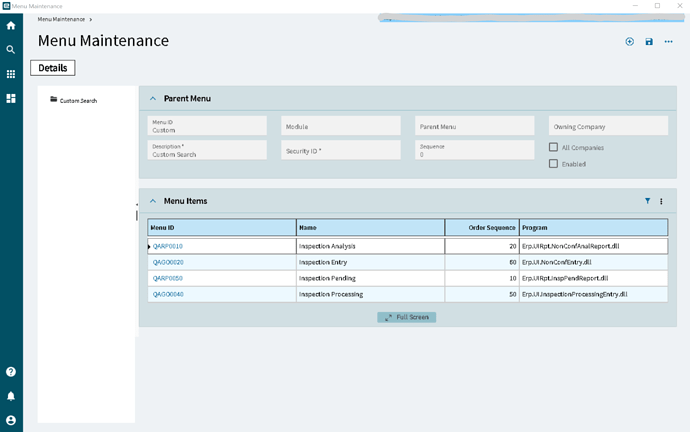

As I was trying that I noticed something interesting. If I open the menu item using the menu search these are my results.

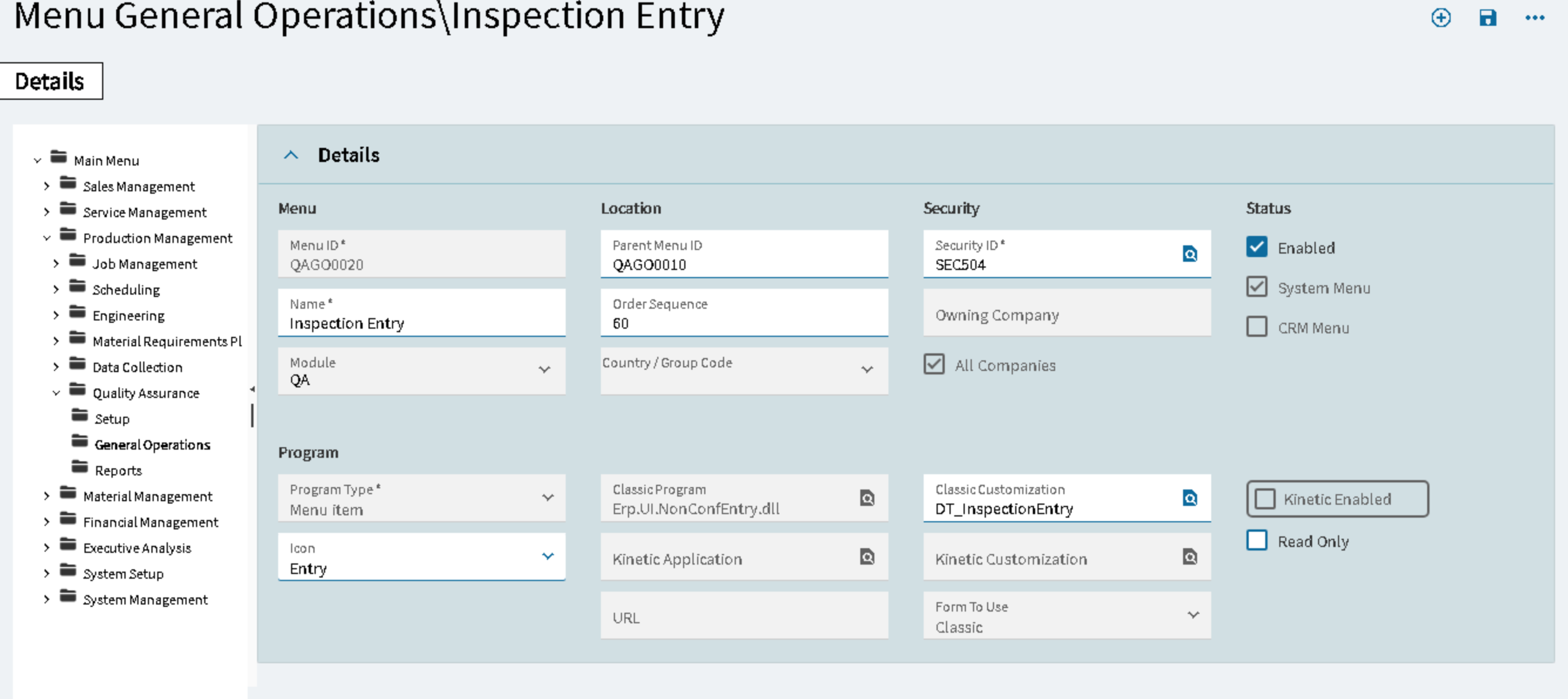

If I open the menu item using the menu path I get these results.
One shows my classic customization and the other doesn’t. Are they not the same menu item?
Very odd, it looks like the same menu id.

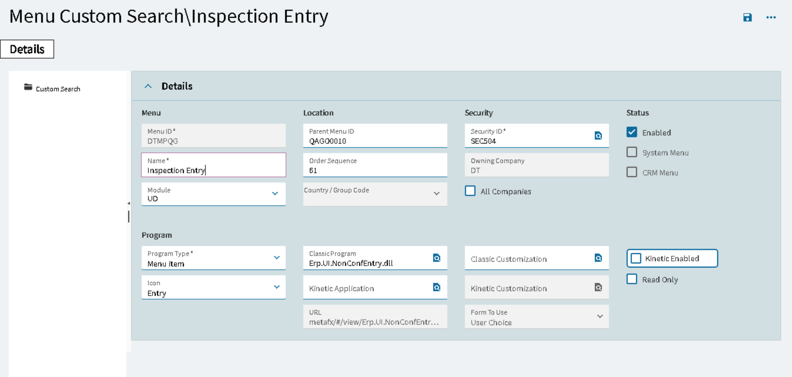

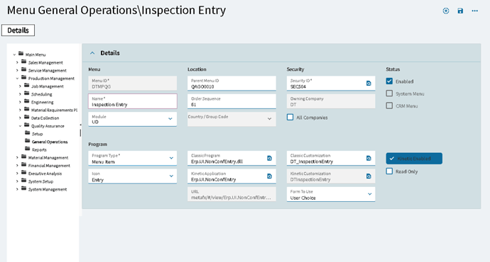

Another detail I forgot to mention in the original post is that my classic customization used to have the same name as my kinetic customization. I was worried this would be an issue so I deleted the kinetic customization and renamed the new customization something else. Which didn’t fix anything.
I think it’s unchecked because the Kinetic information has been cleared.
Also, the Program Type being set to “Menu item” will prevent you from adding the Kinetic information back in. How did you clear out the Kinetic info? Mine are read only.
I didn’t clear it out. It just cleared it’s self when I refreshed.
I’m curious what support has to say about this.
I just created a new menu item with the same info and it seems to be working. I believe there is a bug in the Menu Custom Search that clears the customization fields. When you open the menu item using the menu search instead of finding it in the path the customization fields are blank.
I think that’s how those fields got cleared. I might have noticed the classic customization field was blank and filled it in with my customization and saved.
